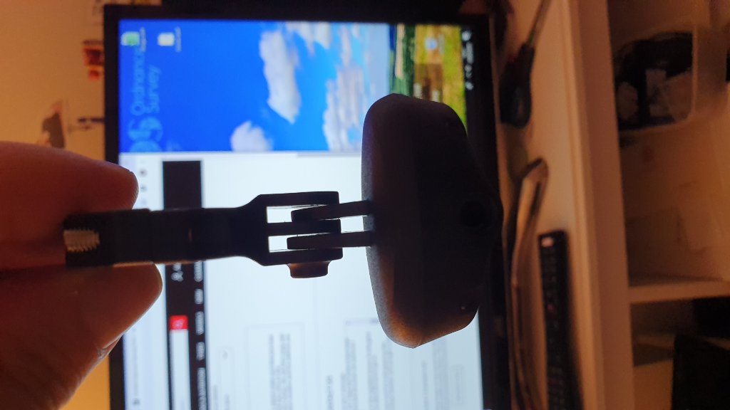

On an unrelated note, the V3 PowerPod appears to have slightly different GoPro tabs to my V2. It won't fit in the existing mount that came with my V2 or the 2 combined Garmin mounts I have (the V2 fits on them). Also it does not fit on the mount supplied with the unit (it is too tight to get the tabs into the mount). My V2 PP also does not fit in the mount supplied with the V3. However, I have a couple of eBay purchased GoPro mounts which the V3 does fit on. I have just ordered another one so I have a mount for each bike.

I have contacted the seller (ProBikeKit.com) to request a new unit. Fingers crossed the button works and it fits the mount! I have attached an image of the mount, so you can see the issue. Looks like the PP tab gets too wide for the mount at the bottom. Same issue on my combined Garmin mounts but fine on the eBay handlebar mounts I have which are a bit wider. As I said even the V2 does not fit in this mount.
Regards
Disappointing as I had to return 3 V2 devices when which were faulty on purchase and eventually only got a working one when Tom Gore intervened and sent me one direct from the factory. Your support is great but the QC does not seem to be the best.

Re: Upgraded to V3 PP - some setup advice
I'm sorry your button does not work.
If you spread the tabs apart just a bit on your mount you will get an easy fit.

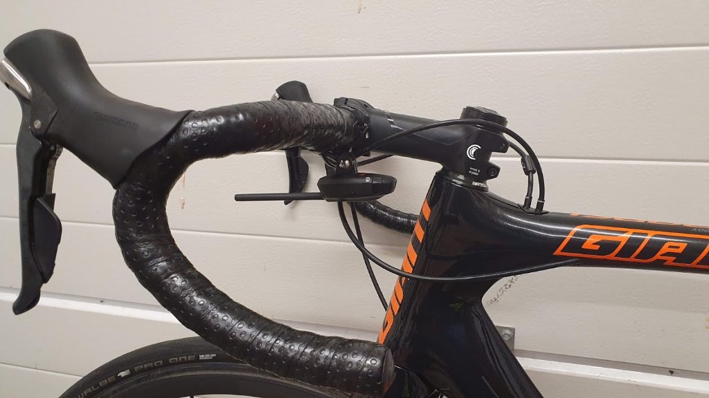

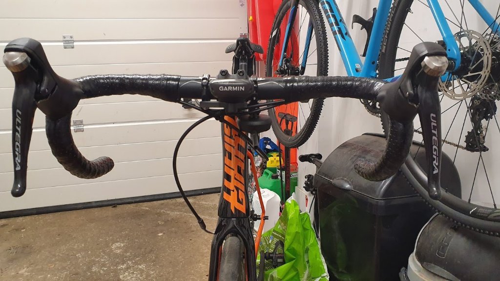

Copied my existing profiles across and it recognised the sensors etc immediately and paired with my Garmin 810 with no problems on both my road and commuting/winter/Swiss Army Knife bike. I have attached the a couple of images of the mounting on the road bike (on which I am using Giant RideSense which worked fine for anyone who has a Giant Bike, it is Garmin magnetless sensors on the other bike).
I have angled the PP V3 down slightly as recommended by John Hannan as the main reason I upgraded was to improve the use in the rain. Sods law on todays ride, despite thundery showers forecast it was very sunny (unusual for Scotland). So will need to wait for a wetter day to test that bit.
The unit is a bit bigger than I thought and the Pitot tube looks longer than the original AeroPod pictures I saw. However it sits well below the bars and under the Garmin so not to bad. I can also see the status light easily so good for calibrating etc. I did toy with trying to mount it below the stem but decided having it slightly offset should assist in keeping rain issue to a minimum. Just my OCD of having neatly hidden beneath the stem rather than a practical reason. Like my first PP V3 it does not fit in the supplied mount. I know John has suggested opening the mount tabs but I already had other eBay mounts fitted which take the PP V3 with out any issues. Having had tabs break off on my V2 PP I did want to force anything.

Received the replacement PP V3 today and all good and in fully working order (first one definitely had a faulty button which had no feedback).
