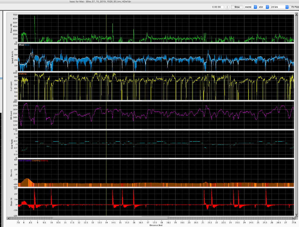

Hi, my powerpod has become erratic recently. I performed a hard reset and then and out and back ride. One the next ride it recorded a very low power. The 20 minute power was 71W. I"m recovering from an illness, so my power is really down. But I expected the 20 minute power to be more like 150W. Aside from the obvious hills at each end of the ride, the flat land is one large flood plain, so the spikes of steep climbs in the middle of the ride are odd.
I've attached the ride file - this is the 50KM one.
Next ride it kept cutting out and I needed to re-press the button to start it again. But When I reviewed the ride files it filled in below the wind line with blue shading - as if it was the strongest wind ever. There wasn't much wind that ride. The readings were odd all ride. Particularly the section between 9.5 and 10KM where the cadence was 80-100, speed was rising and the power was 0W. This is in the 17KM ride file attached.

Your 50KM ride shows lots of speed sensor dropouts. These are the source of all your watts problems; they are causing huge slope spikes. I would replace the battery in your speed sensor.
- Screen Shot 2019-07-18 at 6.51.00 AM.png (163.3 KiB) Viewed 2713 times
I checked a few sections of the ride where speed signals were normal. Your watts were normal, too. I think 150W is too high an objective right now, given the speeds you are traveling (that's OK...)
Your second ride file shows a blocked wind sensor. Were you riding in rainy conditions? Make sure your wind port is clear.
Please post another file once you have the speed sensor issue sorted.
