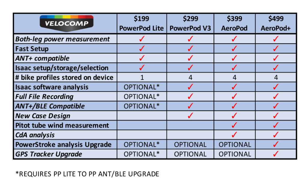

I searched the website but and reviews but can't seem to find what the real differences are between the two when used purely for power measurement and not for stroke analysis. The case difference is obvious but is there any other differences that might effect performance?

We have a chart that shows the differences (attached).
To summarize:
1) There is no difference between models when used for power measurement
2) PPL stores 1 profile; V3 stores 4 profiles
3) PPL records only the first 10 minutes of each ride file; V3 records the entire ride
4) Case designs are different
To summarize:
