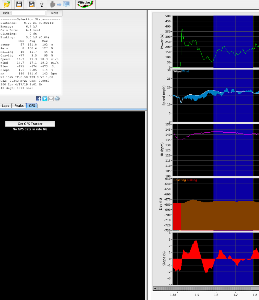

Here is a short snippet of your ride, where power varies by 140W (57W to 192W)
Screen Shot 2019-04-19 at 11.04.25 AM.png (145.7 KiB) Viewed 2580 times
In this section of road, which to the eye would seem flat, in fact there are slope variations from -1.1% to 1.4%. Your bike speed varies from 16.7 to 18.3 mph. The wind is pretty calm. Changes in bike speed and slope are enough to move your power all around.

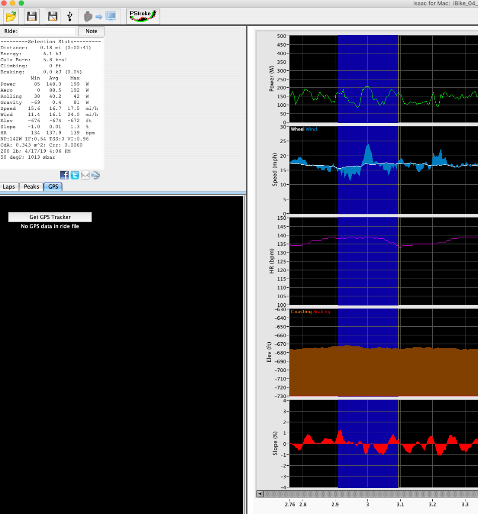

Here is another section, where changing winds pushed your power up and down:
Screen Shot 2019-04-19 at 11.08.13 AM.png (152.8 KiB) Viewed 2580 times
As you become more accustomed to power, you will get better at managing your pedaling for a constant power output.
