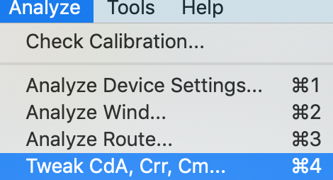

Just for fun, I used this command, to estimate the rolling resistance in the section in question.
Screen Shot 2019-04-28 at 1.56.22 PM.png (172.29 KiB) Viewed 5562 times
I assumed your watts were about the same in the mud section as elsewhere (198W). So, by experimenting I determined the value of Crr rolling resistance that would increase your mud watts to about 198W. The value is about 0.03--about 3x higher than the lower rolling resistance elsewhere. This means that the rolling resistance in the mud section is much more difficult to bike through--which is what your body told you the entire time! :D
