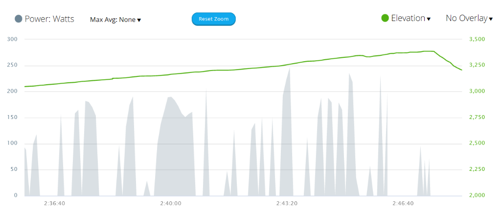

Symptoms: Turn on PowerPod, spin up the speed and cadence sensors, Edge 520 detects all three (plus ANT+ HRM and phone's Bluetooth). Start riding, everything looks good. Next time I check the Edge 520 display, power is reading 0W (despite non-zero cadence, and about 100W effort). For the remainder of the ride, reading on the Garmin will randomly alternate between a valid power reading, 0W, and __W. The valid readings usually don't persist for more than a few seconds. At no point does the Garmin ever report that it's lost connection, or reconnected the PowerPod. Here's a snapshot from the Garmin data:

Your ride file data is 100% intact. Speed and cadence sensor data are normal, too, so there is no problem with your ANT sensors.

Thanks for checking. I do have many rides where everything worked fine. It's the infrequent but recurring nature of the problem that makes it so frustrating as it typically surfaces well after I've started to trust things again and it's incredibly difficult to know with any certainty if changing something has any effect.Velocomp wrote: ↑Mon Apr 08, 2019 6:07 am Your ride file data is 100% intact. Speed and cadence sensor data are normal, too, so there is no problem with your ANT sensors.

1) To hard reset PP, press-hold its button for about 12 seconds. You'll see the light go out momentarily, then start flashing again. Release the button. You should connect PP to Isaac afterwards, to reestablish its date/time clock.
2) I am 99.9% convinced that its your Garmin misbehaving. This is because PP is working properly (ride files are fine) and your PP is very close to the 520. Hopefully removing sensor IDs from the Garmin will do the trick.
