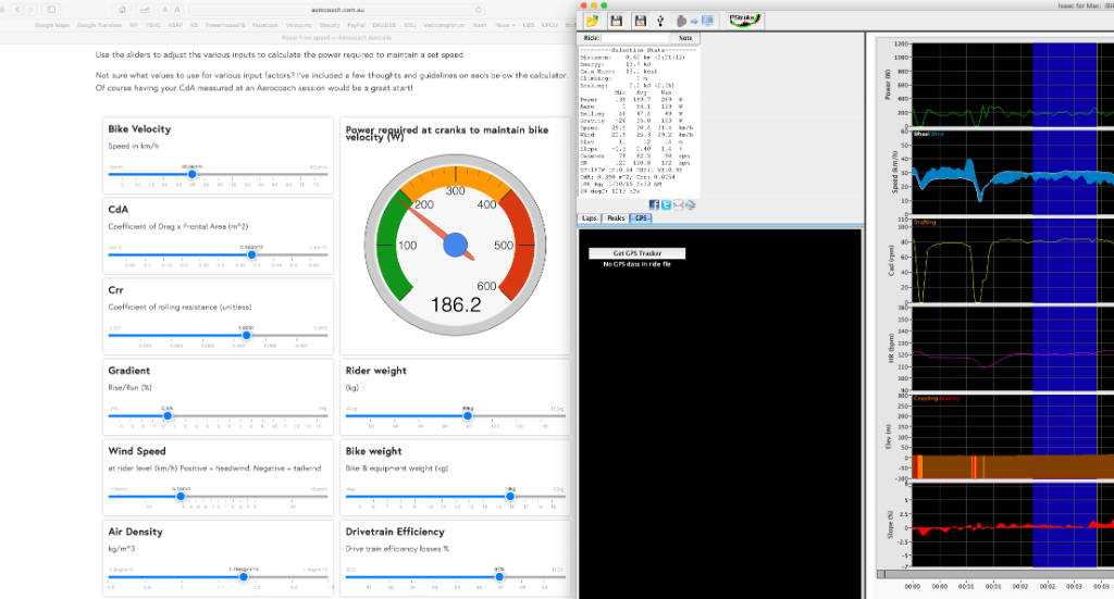

I opened your 'iBike_01_30_2019_1831_6_km' ride and picked a section where speed, wind and slope conditions were constant. You'll see this in the attachment below.
On that section of road, I input the measured parameters to "aerocoach australia", which is a nice website for checking things.
Basically, on the website you input rider/bike weight, bike speed, wind speed, Crr, CdA, and slope. It returns power.
The website was within 3 W of your PP (186 vs 189). So, it appears that PP is running its calculations properly.
Screen Shot 2019-03-17 at 11.49.22 AM.png (168.59 KiB) Viewed 5140 times
Your view is that PP is always about 25% high compared to your Wahoo Kickr. If you are correct then your power in this section should have been 139W.
For your wattage to be "wrong", one or more of the following would have to be true for the section selected:
measured wind speed (25.3 km/h) is wrong
measured bike speed (30.4KM/H) is wrong
CdA (0.390) is wrong
bike/rider weight (106KG) is wrong
slope (0.40%) is wrong
I'm going to assume you entered your bike and rider weight correctly.
Looking at the elevation graph, it appears that you are riding on a nearly flat section of road. Note that slope reading and elevation readings come from two different sensors; if slope were wrong, then the elevation graph would reflect that. You don't have that problem.
You have wheel circumference set to 2136 mm (700 x 28c wheel). I have no way to determine if that is correct. However, if your wheel circumference were 25% smaller that would reduce your power by 25%. I don't know of any road bike wheel that is that small.
Your CdA is 0.390. If you were riding on the hoods this seems correct for a person of your weight. If you were riding in the TT position, then your CdA would be too high; this would cause high watts. The CdA that adjusts down your watts to 139W is 0.209. This CdA in the range of an elite time trialist, with a small body, riding in the TT position, with skin suit and aero helmet.
If your CdA is correct, then a high Crr would cause high watts. However, even if your Crr was "0" (frictionless tires and pavement), that would not reduce watts down to 139W.
The final factor is wind. To reduce watts to 139, you'd have to be in a -12km/h tail wind. You MIGHT achieve that level of tailwind if you were riding in a group, but the profile of your wind doesn't suggest you were riding in a pack.
So, looking at your data, if you really want to reduce your power by 25%, you can adjust your CdA to 0.209. I don't recommend making this change unless you think it matches your ride position and equipment.
iBike_01_30_2019_1831_6_km.ibr
(60.55 KiB) Downloaded 343 times

Re: Calibrate PP with a Wahoo Kickr Core
To use Aerocoach properly is tricky. The software assumes that the variables you enter are unchanged. In real riding, that is not easy to achieve!
In ride files I look for sections where things are reasonably constant: bike speed, wind speed, and slope. I also look at the power; hopefully it is not varying too much (power can be significantly affected by small changes in slope, wind, and cadence).
If too large a section is selected, then it's likely that the variables are changing. If too small a section is picked, then its likely that transient changes in power won't yield a good average value.
For the above reasons, agreement within 10W is close enough.
One other thing: though HR does correlate to power, HR can be tricky, too! At the five minute mark you did a 30 second sprint of 1000W (nice!). Your HR spiked too, but it took about 2 minutes afterwards for it to recover to its prior value. So, if you're going to try to match HR and power, make sure you pedal at an even pace for several minutes.
