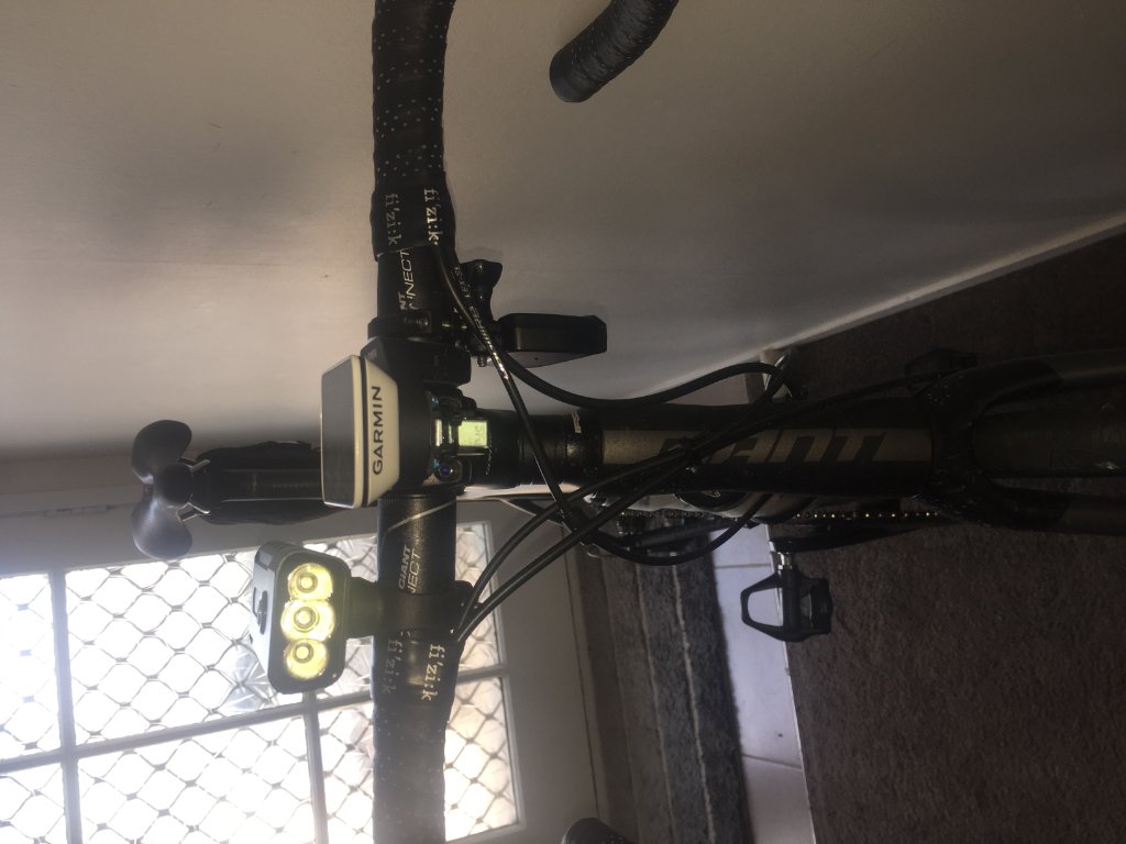

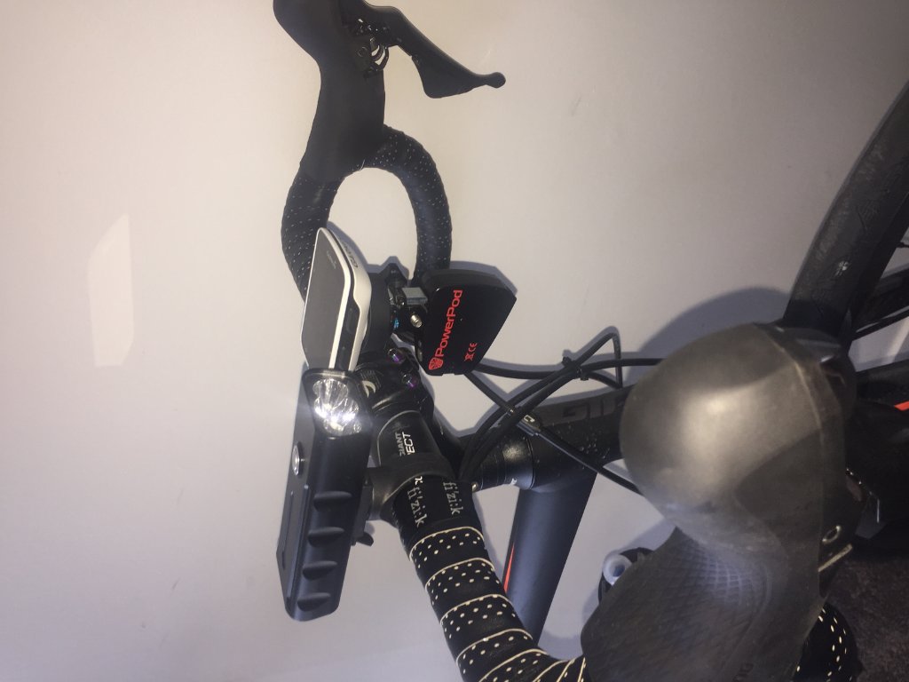

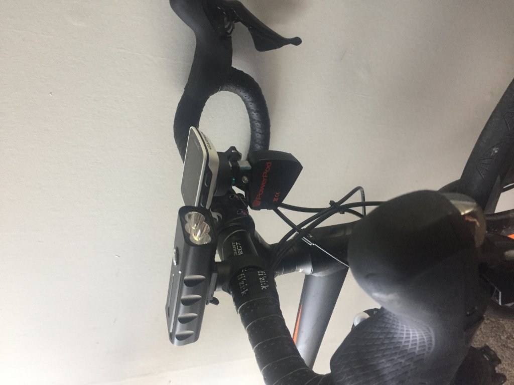

Please post images showing how your device is mounted.
pieterkiwi
- Posts: 10
- Joined: Thu Feb 21, 2019 11:03 pm
Re: Powerpod data all over the show
Here you go. attached pictures are of the 2 positions I have. First I had the PP out front under my garmin mount with nothing in front or to the sides. Now I have it under the Handlebars on the left side and cables are out of the way, cable tied so that they font get in front of the PP during my ride.
- IMG-5365.JPG (68 KiB) Viewed 7628 times
- IMG-5366.JPG (92.07 KiB) Viewed 7628 times
- IMG-5367.JPG (72.54 KiB) Viewed 7628 times

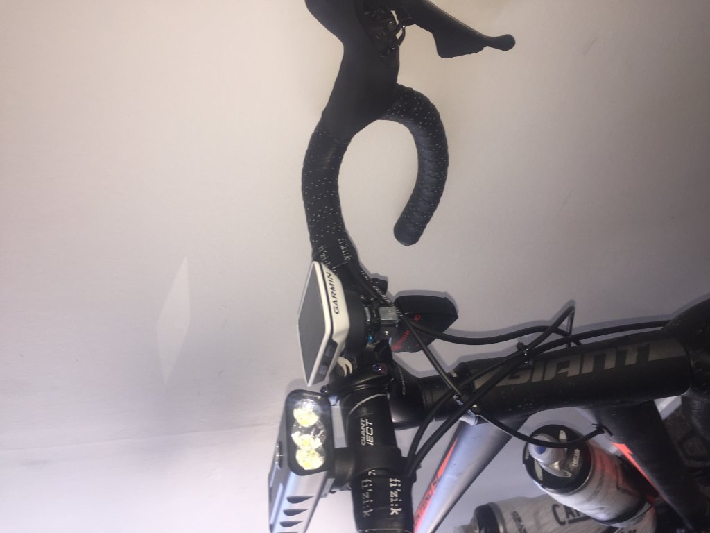

another image
- IMG-5364.JPG (86.18 KiB) Viewed 7628 times
