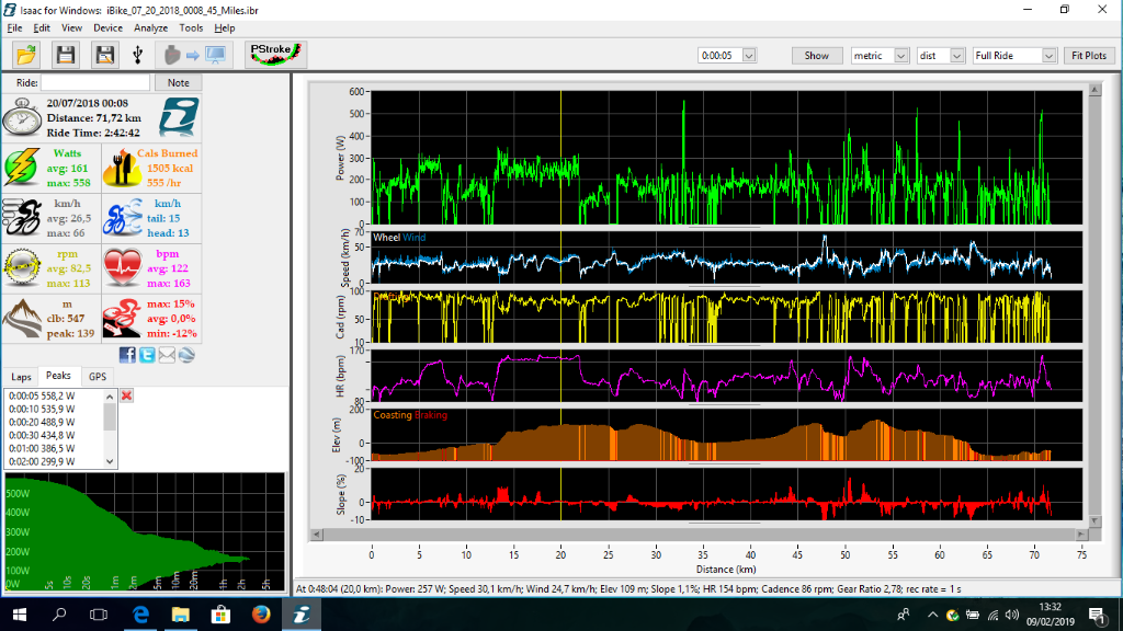

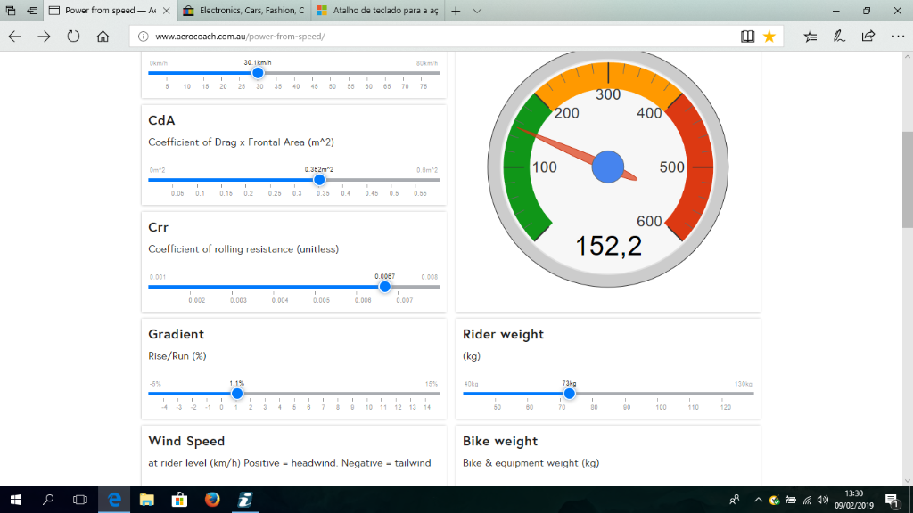

Hi again John.
I just used the tool that you mentioned in another post and the Power values are very far from those of PP.
I attached two print screens:
1 - tool analysis of data at 20km of the ride (bike weight is 10kg and I input wind at -15 km/h, because Isaac shows 24,7 km/h tail wind): 152W
2 - isaac data at 20km of the ride: 257W
Why so much difference?!
B

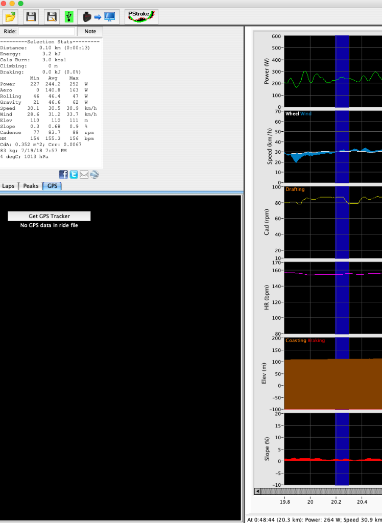

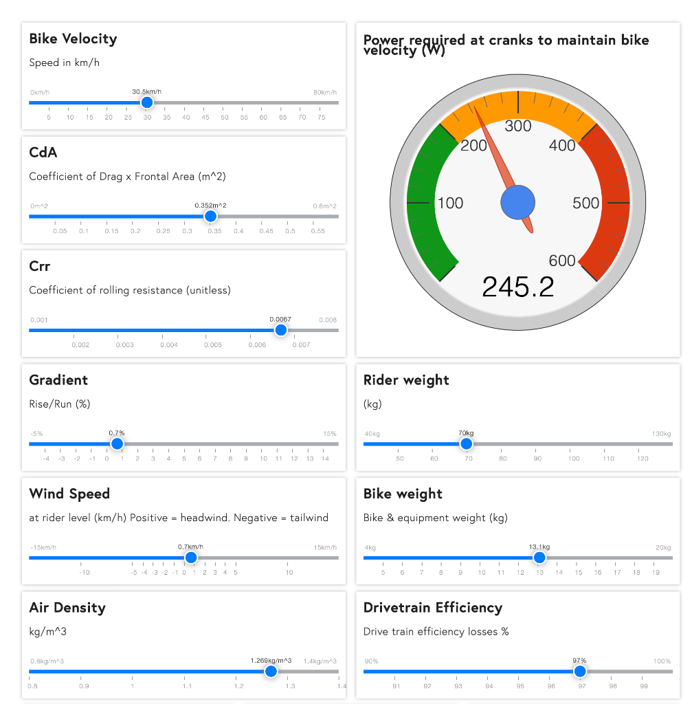

Re: PP calibration
When using web software you have to be extremely careful to provide the proper inputs.
You can't take a single point of data; rather, you find a place where conditions (speed, slope, wind) are fairly constant.
I looked at your ride file and selected data around the 20.2 KM mark.
In the selected region Isaac reports 244.2 watts
In this region here are the parameters:
Bike Speed: 30.5 km/h
Wind speed: 31.2 KM/h (0.7 headwind)
Slope: 0.68%
weight: 83KG total
Air density: 1.251 kg/m3
Car: 0.0067
I input those numbers into the web software. Result: 245.2W
You are OK...
