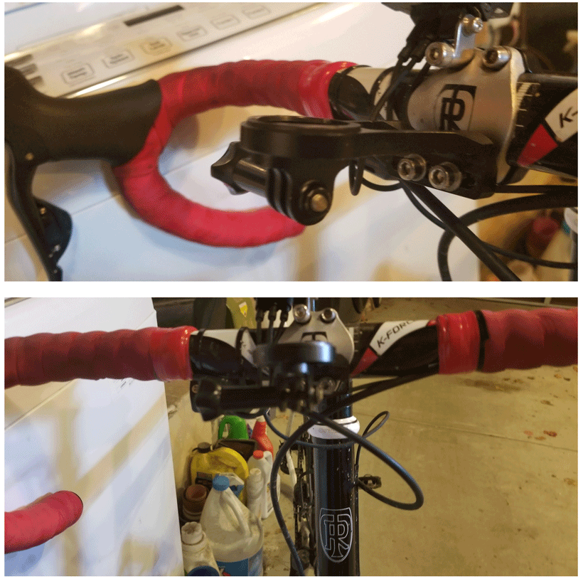

However, both rides show evidence of changing mount angle. What kind of bike are you using? Please post images of your mount setup.

Ritchey Breakaway Road Bicycle, with a stem extension mount. Lightweight steel frame, carbon bars and fork.
Garmin Edge sits on top, PP mounted to GoPro fitting on the bottom. I was not 100% sure as to proper PP positioning, was reluctant to tighten too hard, rick cracking one or both of the mount fittings.

scuba_cyclist wrote: Mon Jan 07, 2019 1:54 pm I was not 100% sure as to proper PP positioning, was reluctant to tighten too hard, risk cracking one or both of the mount fittings.
Your mount looks fine.
However, if your PP can rotate AT ALL in the mount, that will cause problems. Don't worry about cracking the mount fittings; they will hold-up.
