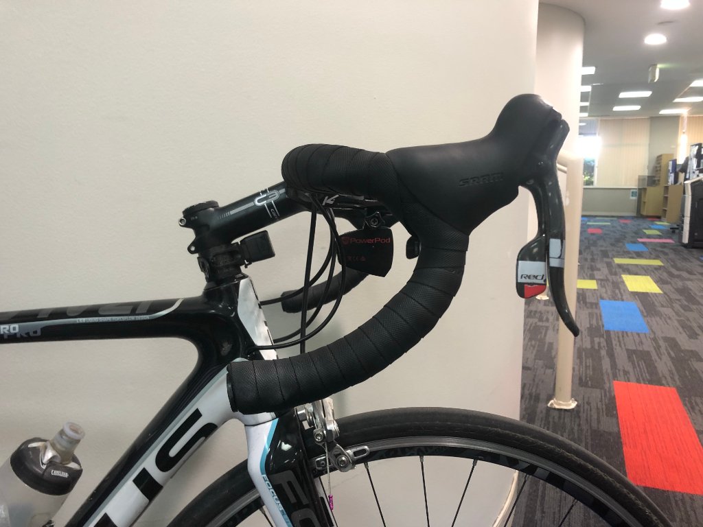

I have checked if the Powerpod is level and have attached a photo. I have been through the forums to search for any other solutions however I am not having much luck.
I have attached a photo of my powerpod

Re: Calibration
You've downloaded your profiles but your .ibr ride file and your photos are not attached. Please post these and we will take a look.

Re: Calibration
I think something may be wrong with your wind sensor. Please email technicalsupport@velocomp.com for next steps.
If you don't hear from Tom within 24 hours please check your spam folder.
