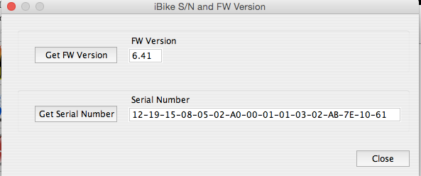

Hmm...please do the following:
1) Connect your unit to Isaac
2) Go to Edit/Edit Profiles
3) Click Extract from Device
4) Copy/save the profile, and post it here
5) Go to Device S-N and FW version
6) Take a screen shot and post it here

Re: Powerpod is not recording rides
Here's the extracted profile and FW/serial #
- Screen Shot 2018-07-29 at 12.11.41 PM.png (24.5 KiB) Viewed 8548 times
