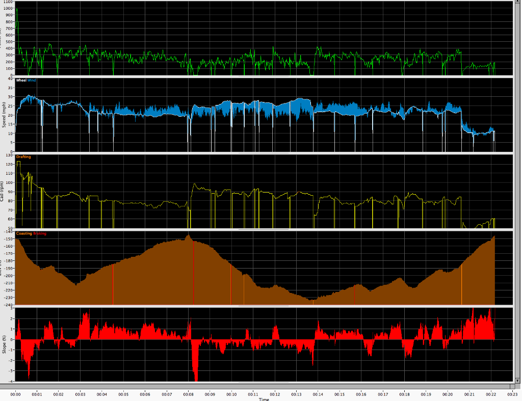

Your guess is dead-on. Your speed/cadence sensor is showing a ton of dropouts.
You'll need to change it.

- Screen Shot 2018-06-26 at 6.15.28 PM.png (137.29 KiB) Viewed 4981 times

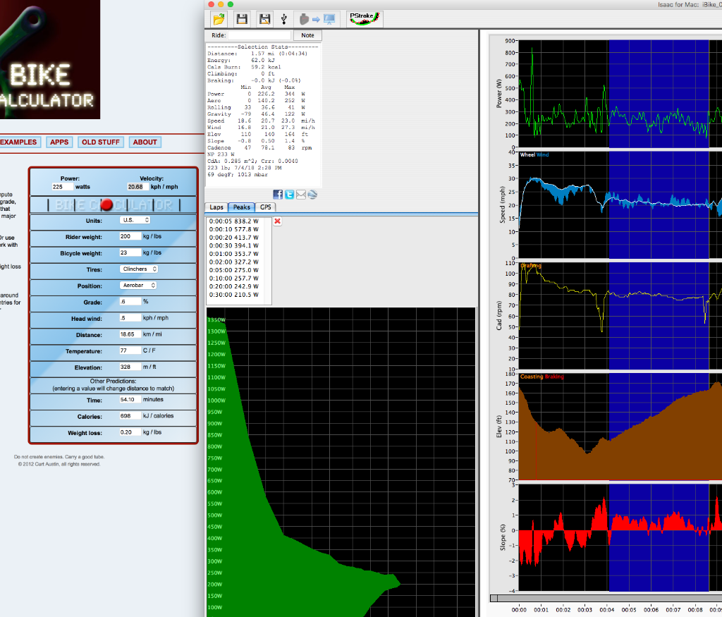

I used bike calculator.com to check your TT ride. It's a bit tricky to do this because the calculation assumes all values are constant; this is not strictly the case for you (you have some gusts of wind, your bike speed varies slightly, and hill slope changes a bit too).
Using the weight parameters, ride slope, wind speed, and bike speed, for the highlighted section PP is within a few watts of the calculated amount.
- Screen Shot 2018-07-05 at 5.02.49 PM.png (344.67 KiB) Viewed 4924 times
