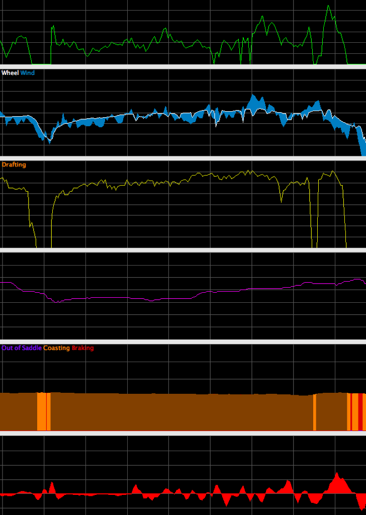

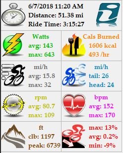

Apparently I don't know how to read the data in Isaac because in the app the headwind and tailwind are showing much higher numbers than 8mph. I am just randomly selecting points and looking at the data at bottom of screen(attached). How did you come up with 8mph? The data in he left side (attached) shows tail 26mph and head 24mph. I'm confused at what I'm reading.
By the way, very impressed with your responsiveness on this board. I hope you get some free time! Thanks!
Mark
Mark

You're using the "basic" display icons. I prefer the advanced stats display; to view it, place your mouse over the icons, then right click and select advanced stats.
In the advanced stats window you'll see average bike speed and average wind speed. The difference between the two is about 8 mph.

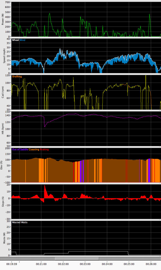

Your speed sensor is misbehaving. You can see dropouts on the bike speed graph. What kind of sensor do you have? Where is it mounted?
In the 6/7 ride I looked at, you are pushing 338 watts up a 7% grade at the end of the ride; this is reasonable.
Still, until you get the speed sensor problem fixed, your data will be flaky.
By the way: I LOVE your handle! I purchased one of the first Kevlar canoes made, back in the mid 70s. It is a fantastic material, but I hope you don't have any implants using it
- Screen Shot 2018-06-11 at 11.01.03 AM.png (116.8 KiB) Viewed 16098 times

I would replace the Wahoo sensor with one from Garmin. The Wahoo sensor has dropout problems--something that is widely known.
You won't see speed dropouts on Strava or your bike computer. They last for a very short period of time. This is not enough to cause overall problems, but it is a big issue for PowerPod, which needs accurate and uninterrupted speed data to compute power accurately.

I was a little concerned by your response to kevlar_heart since I'm also using a Wahoo speed sensor. I've just checked the documentation that came with my PowerPod and the relevant page is also available in your support section: https://velocomp.com/wp-content/uploads ... 102516.pdf
My Wahoo speed sensor seems to be performing correctly but it's still a worry if you say they are problematic.7. Most ANT+ speed or speed/cadence sensors will work with PowerPod BLE, for example (this list is not complete):
a. Garmin “magnet-less” speed and cadence sensors
b. Wahoo Fitness BLE/ANT+ speed and cadence sensors (“dual band” operation)
c. iBike speed/cadence sensor
Re: Calibration - Numbers Off???
Unfortunately this is a somewhat complicated subject.
The link you provide is about the BLE version of PowerPod, and the Wahoo sensor reference in that document refers specifically to Wahoo's BLE implementation of speed. We have not seen any issue with Wahoo BLE speed signals.
The Wahoo sensor is both BLE AND ANT+; where we see issues on the ANT+ side.
The speed data below is from a Wahoo ANT+ sensor. You'll notice speed notches throughout the section. We don't know why this happens; what we do know is that Wahoo is the only sensor where we see this problem.
All of this aside, I don't mean to cause unnecessary alarm. Glitches in speed signals can make the power signal more noisy, but that doesn't mean the power data is "bad".
