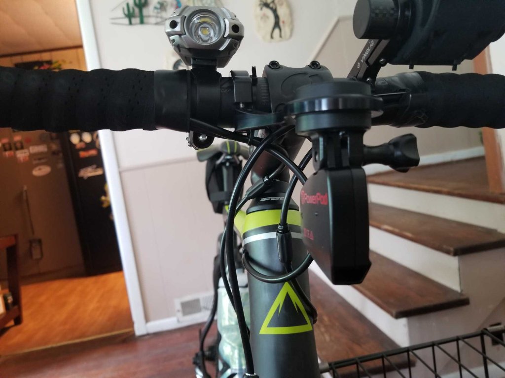

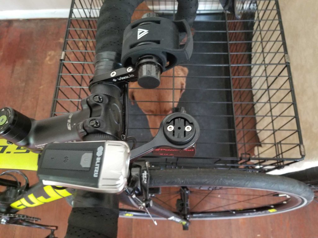

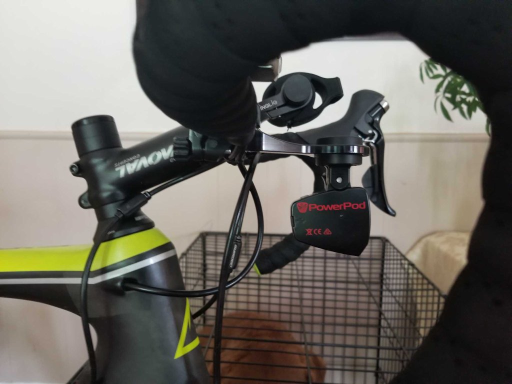

Please post images of your PP mounted on your bike. Top, front, and side views.

Your PP looks to be properly mounted to your bike.

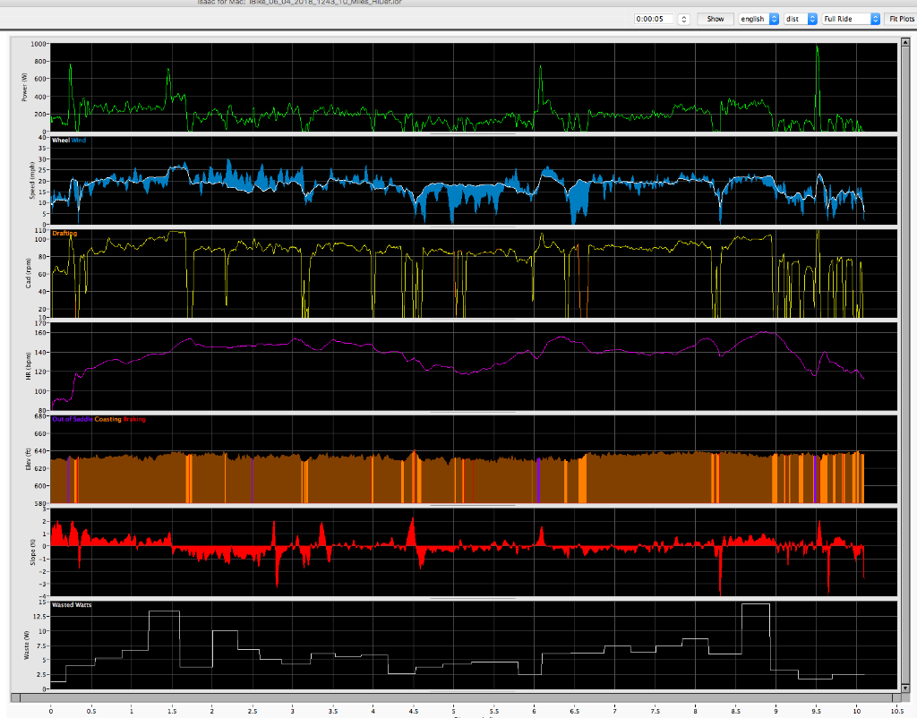

Sorry, just noticed I had my days/date wrong. Monday the 4th was the previous successful ride which is attached above.
Re: review ride file please
Your 6/4 ride is fine. Out-of-saddle is approximate; don't worry if it does not show up perfectly.

I'm guessing, but perhaps your 3/20 ride file was on a unit that was very low on charge.
The 3/20 ride file does not show cadence or HR wireless IDs. That is why you don't see that data.
Your 6/4 ride shows HR/cadence IDs. That is why you see the data.
I see wasted watts, HR and cadence data in the 6/4 ride.

- Screen Shot 2018-06-07 at 7.44.12 PM.png (140.46 KiB) Viewed 18221 times
