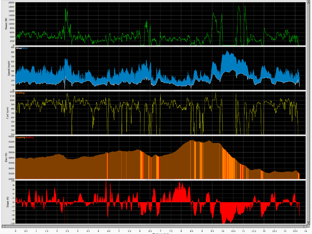

Not sure if this is the right place to ask, I apologize if its not. I have had a powerpod for about 3 years. For the first 2 years it worked very well, reliable and gave me consistent data. Then I made the 'mistake' of trying to improve, hooked it up to issac for newton and tried to calibrate it better. That was a year ago and while we don't ride in the winter, I have never been able to get it reading accurately or consistently since then. Finally last week I read everything, cleared out the device and recalibrated, 3 times trying to make sure everything was done correctly. It seemed to go fine but today I was getting results that were clearly off. I can't put out 1500 watts, and certainly not down hill and not pedalling. It goes all over the place in terms of power as well, ie no consistency. Does anyone have any suggestions about what to do? I bought this on line so not sure where to proceed. For what its worth I run it with a garmin 1000 and that has never been an issue. Thanks in advance.

Your Isaac ride file shows downhill speeds of 80 mph...that is race car, not bicycle, speeds!

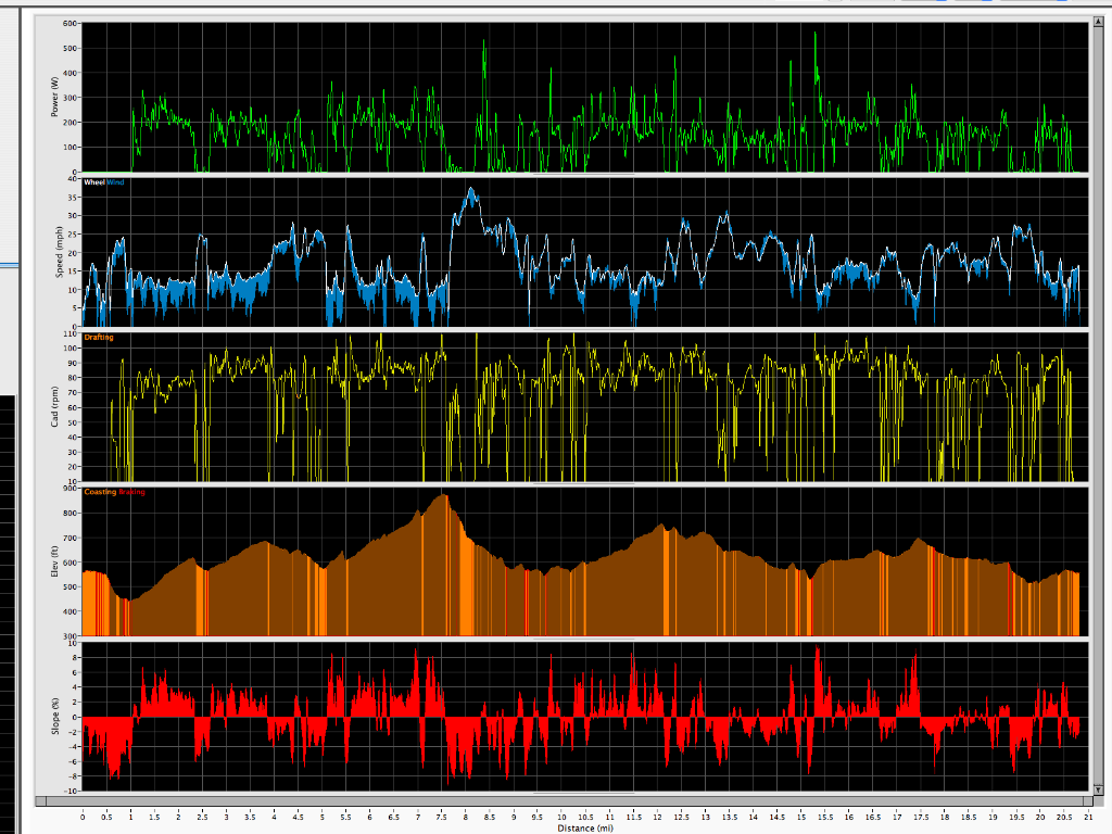

I did the new sensor pairing and here is the file. I looked at the speed on my garmin when I was 'hitting' over 1000 watts - it was only about 34 km/hr. Thanks as always, sorry to be such a pain. They were all one ride, not sure why it got broken up into 3 files.
Re: Need some help with powerpod
oops they may not have downloaded
- iBike_06_03_2018_1026_22_km.ibr
- (192.08 KiB) Downloaded 356 times
I'm not sure how it happened but your unit is grossly miscalibrated; wind speed is a constant headwind (see image).
I have guessed at a correction. Load the attached profile in your unit and post a new ride file afterwards.
- GGG58_06_03_2018_1026_22_km.ibr
- (204.12 KiB) Downloaded 305 times
- GGG58.ibp
- (413 Bytes) Downloaded 329 times
- Screen Shot 2018-06-03 at 5.12.57 PM.png (145.42 KiB) Viewed 14593 times

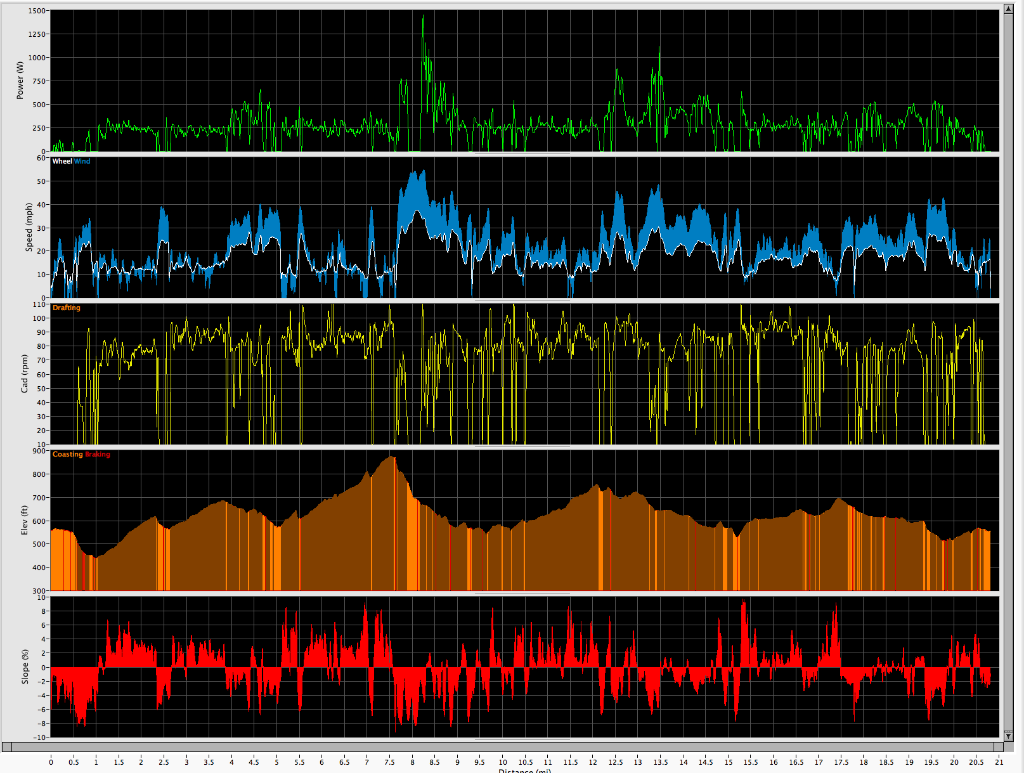

Please find attached a copy of my ride from 2nd June which had a peak power of 1450w.
- iBike_06_02_2018_0854_21_Miles.csv
- (419.11 KiB) Downloaded 339 times
sorry ibr file attached
- iBike_06_02_2018_0854_21_Miles.ibr
- (272.99 KiB) Downloaded 279 times
Your wind calibration is wrong; I can tell because there are headwind "flames" constantly.
I adjusted your profile. Load it into your PP and all should be well.
- Sincy.ibp
- (426 Bytes) Downloaded 207 times
- Sincy_06_02_2018_0854_21_Miles.ibr
- (292.73 KiB) Downloaded 247 times
- Screen Shot 2018-06-06 at 2.09.39 PM.png (164.87 KiB) Viewed 14509 times
- (292.73 KiB) Downloaded 232 times
- Sincy.ibp
- (426 Bytes) Downloaded 294 times
- Screen Shot 2018-06-06 at 2.06.27 PM.png (170.28 KiB) Viewed 14509 times
