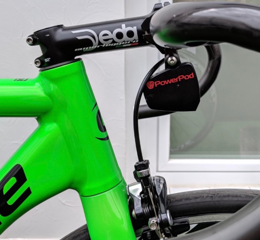

I did a factory reset of my Powerpod and now I cannot seem to get it to do the 10 min O&B ride let alone the 5 min cal ride.
I am able to pair with my sensors
When I go out on the 5 min calibration ride I can see it count from 1 to 100.
It then starts to count again from 1 to 100 over and over again.
Thank you
Re: Help Cannot Calibrate
Likely your PP is pointed too far upwards, like the one in the image.
The word "PowerPod" should be approximately level to the ground.
Reposition your PP then try a new cal ride. Hopefully things will be fixed.
