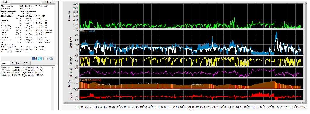

Hi. I`ve been experiencing inttermitent drop outs on power readings in my garmin edge 520. I bought a new garmin speed sensor and the problema persist.

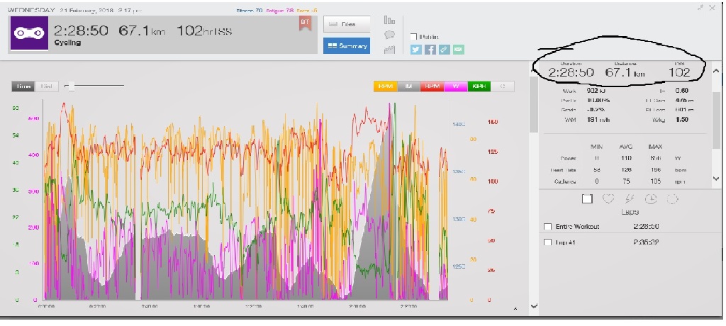

When i`m on a ride, sometimes suddenly power goes to 0 (and I checked that the speed sensor was working) for some minutes and then comes back with high readings until it stabilizes again. Also when I compare the ride file in Isaac with the strava/trainningpeaks or garmin file summery, it turns that the Isaac one is always shorter in time and distance, given that the powerpod is not recording during this power drops to 0. (real ride 67,1km 2:28:50 vs Isaac ride 56,58km 2:18:40)
I also observe that powerpod records several laps during my ride, even though I hadn`t stopped
