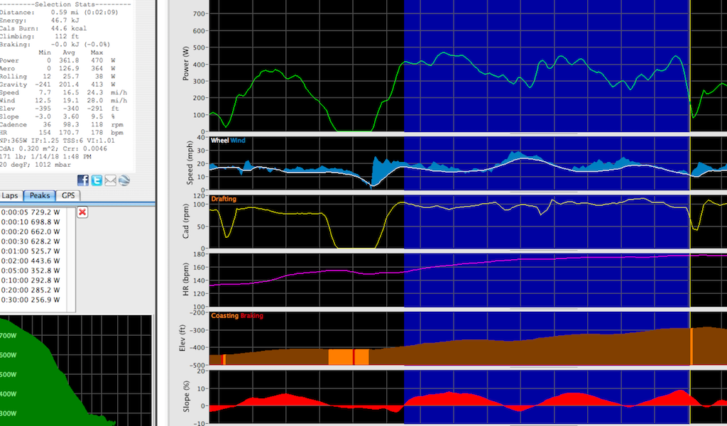

I rode yesterday on rather windy conditions and after looking at my ride in Isaac I noticed tons of headwind.
I did the check calibration tool and Isaac changed my power significantly lower. I do not mind it being lower but I am concerned now on
how accurate the values I see on my powerpod each time if what i see while riding is much higher than how much watts i can really produce.
Although I believe I got stronger, I want an accurate watts since i used zones while training.
my powerpod is using the front mount that i bought with the combo and a garmin on top. I used the calibration ride that I did a few months (with the same front mount setup) back but used the "setup device/keep accuracy of" feature when editing my new weight which is lesser and lowering the cda .10 with my new aero wheels (i read to lower it from another forum post).
Please advice. TY
Please advice. TY

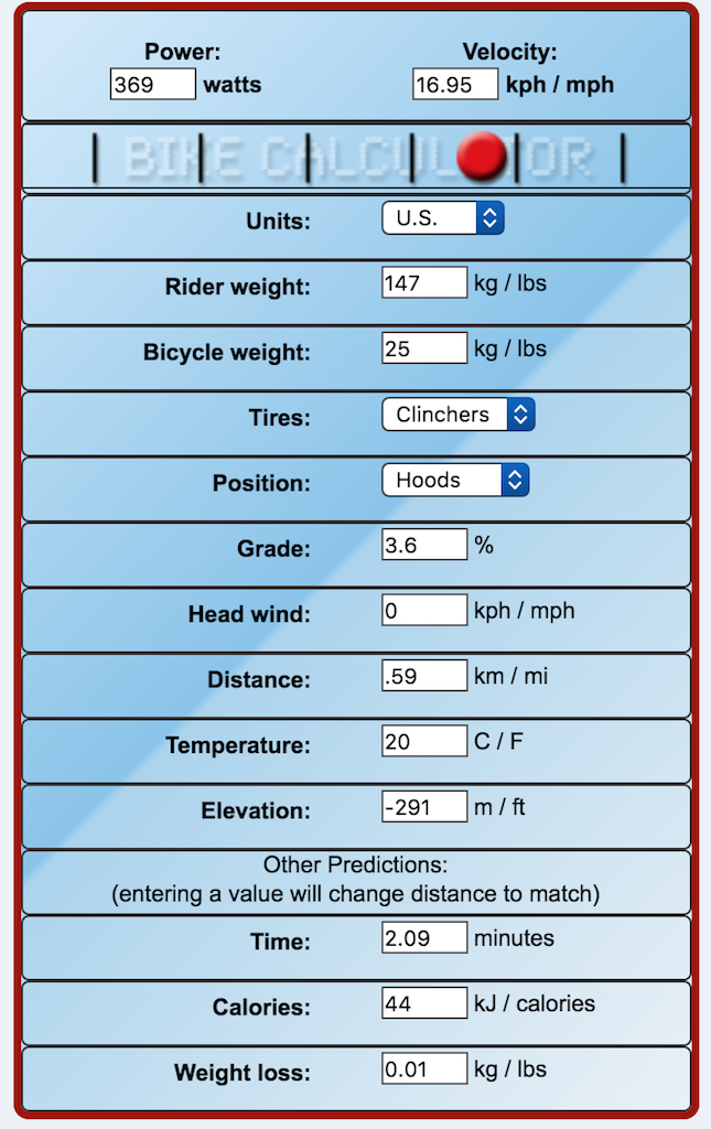

Re: too much head wind?
do you have any thoughts about the file with tons of headwind? it is using the same calibration ride file base.
interestingly enough i was playing with the data and plugging it in the bike calc website and the average speed on some of the segments are matching the power i need to produce required to finish in the same time. hope that makes sense. this is for the file unmodified directly from powerpod.
Its actually attached on my very first post but i will attach it again.
I also attached the segment i am comparing with the raw file if i plugged the data directly in the bike calculator website, the power it calculates is within the ballpark
except without no headwind.
Conversely the power if I apply the "check calibration" tool on that same raw ibr file will lower my power to about 311watts for that highlighted segment.
If i am targeting 311watts according to that bikecalculator I have to weigh 110lbs to hit 311watts to finish with a 2:09 time! There is no way i can lose 30 or so lbs at my current 147lbs weight!
Maybe i am comparing apples to oranges but let me know your thoughts.
I guess what I am saying is even though the raw IBR file at first looked seemed skewed or wrong with too much headwind, it is reporting accurate data after all without using the "check calibration" but thats where i need your input.
I can't tell from your screenshot where you highlighted your ride.
Your ride file shows overall high wind speed. I fixed this with the Analyze/Check Calibration command
I can't comment on your screen shot, because I have no idea where this is in your ride.
