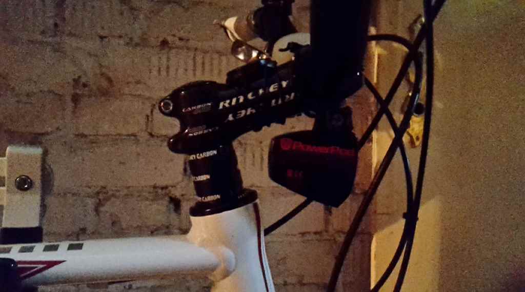

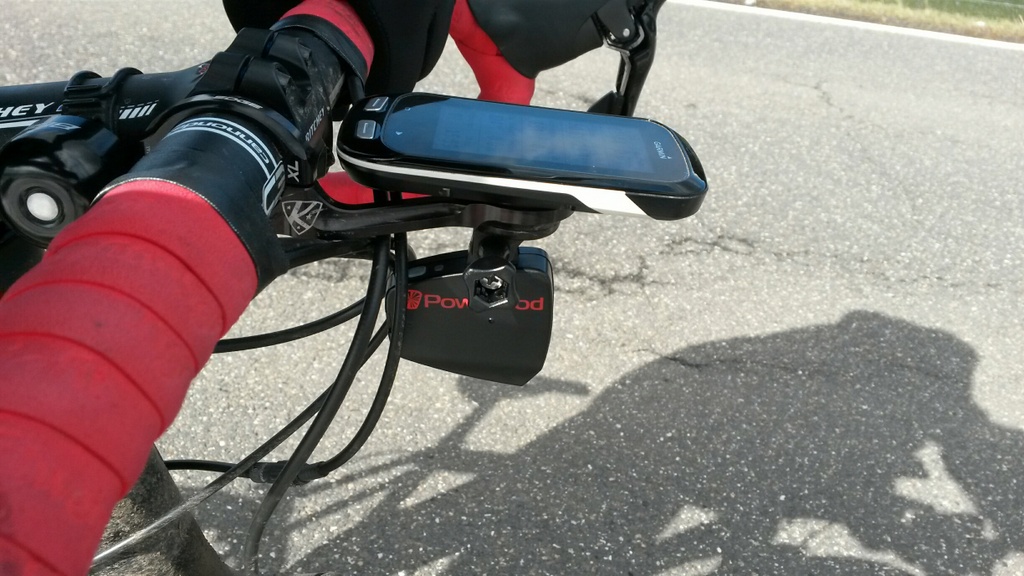

- The place in the future = its a roadbike
- 25065643uk.jpg (214.01 KiB) Viewed 24291 times
- The place for the calibration ride = its a fitbike
- IMG_6085.jpg (15.62 KiB) Viewed 24291 times

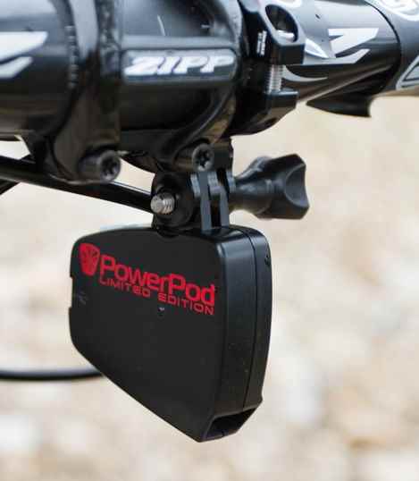

Re: Powerpod Calibration Ride successful?
I can't tell from these photos if your PP is mounted in a vulnerable manner (it isn't your bike)...
What I can say, from experience, is that we have had very, very few failures due to broken tabs.
Yes, not my bikes but the same position
That calms me down a little bit.
Thanks !

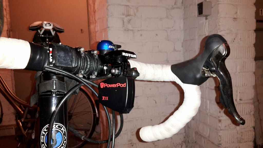

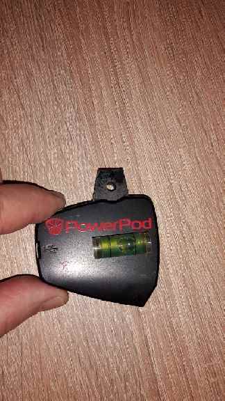

Hello John,
first the pictures from my bikes
and then i have a question/idea for the next version from Powerpod.
With a different attachment, the alignment is not so easy. I got a small spirit level - works perfectly.
You could also attach an even smaller spirit level to the case to facilitate alignment - see picture 1.
Thanks for your help in the past and good luck for 2018

- Spirit level in german Wasserwaage
- 20171228_142948.jpg (30.15 KiB) Viewed 24203 times
- Roadbike
- 20171228_140113.jpg (42.94 KiB) Viewed 24203 times
You are using a Rotor mount with your PP. CAUTION! We have used this mount and it is pretty flimsy (flexible). If you ride rough roads you may not get good performance with this mount.Cooper wrote:Hello John,
first the pictures from my bikesand then i have a question/idea for the next version from Powerpod.
Thanks for the warning !!
I will pay attention and replace the bracket if necessary.
