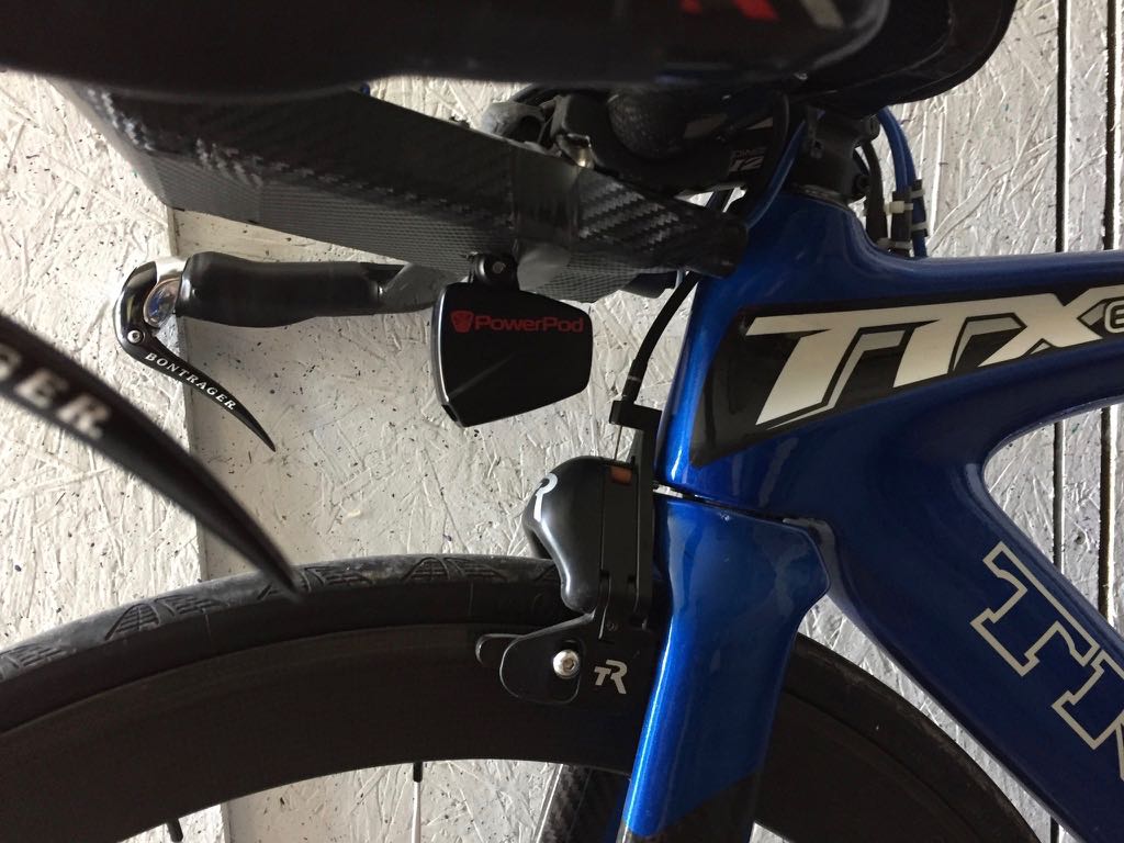

OK, ride is done. I have attached the last cal ride file, the current ride file, and a photo of the PP mount.
FYI the profile is the one generated by the cal ride, except that I altered the CdA to .24.

Re: uphill vs downhill
Posted: Sun Aug 20, 2017 11:08 am
The temperature settings for your unit may be "off". Please contact technicalsupport@velocomp.com for next steps
