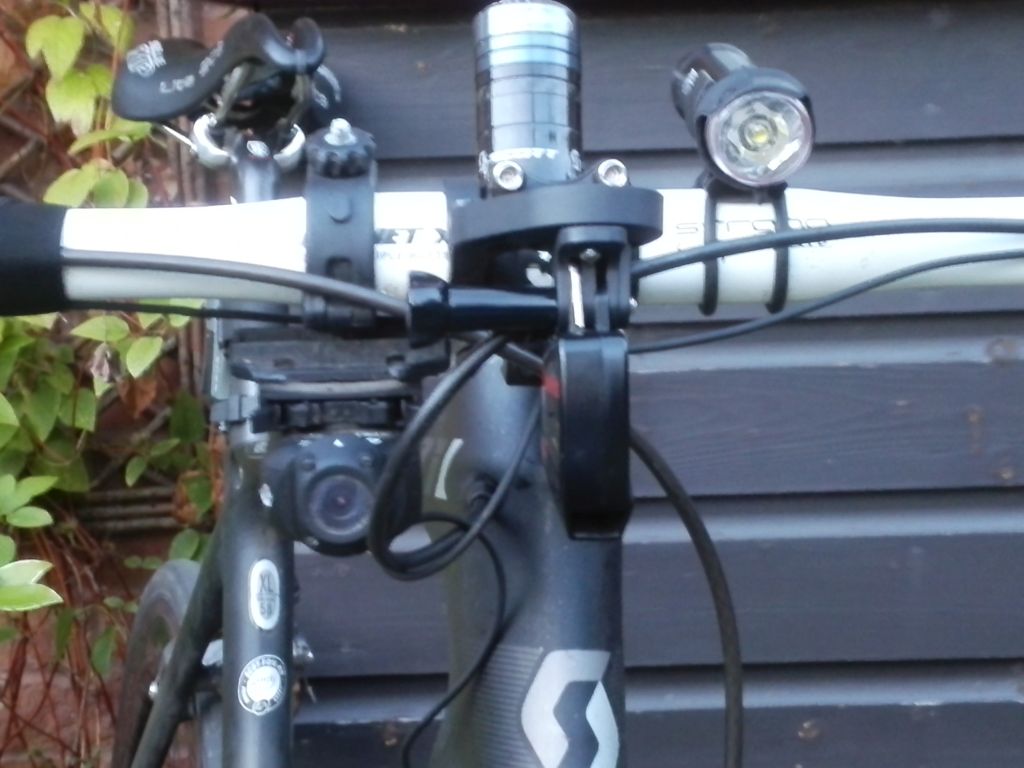

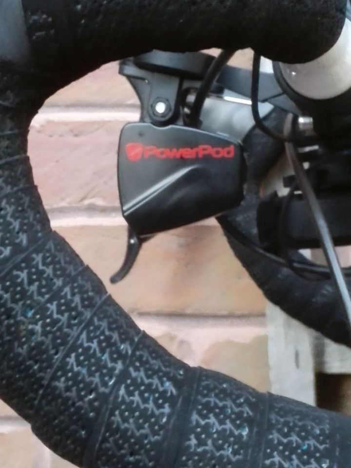

Pics attached I hope
(bar area is fairly "busy", I admit
but everything's well behind the "mouth" of the pod which is pretty much level with the brake levers)
Garmin sits on top of the PPod mount

Your PP mount location looks fine, though I don't recognize the mount. Is it made of plastic?

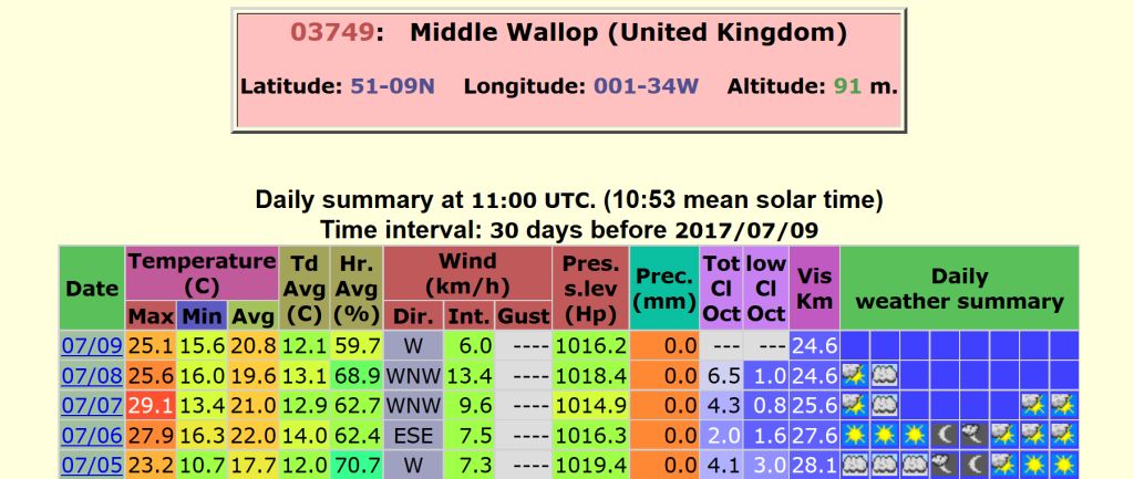

Honestly, wind was nowhere near that - I've attached a screenshot from (http://www.ogimet.com/gsynres.phtml.en) that shows historic wind data for an airstrip 10 miles from my ride site. You can see they also are reporting the 11am wind on Jul 9th as 6mpg, no gusting
I guess I'll delete profiles & start over, just to see what happens - do you think ?
Mount is plastic but really quite rigid, and I had much the same experience with a metal mount directly under the bars

(I took a look; mount is a garmin out-front with an additional PPod mount fixed underneath (bolted on, not a sticky pad))
