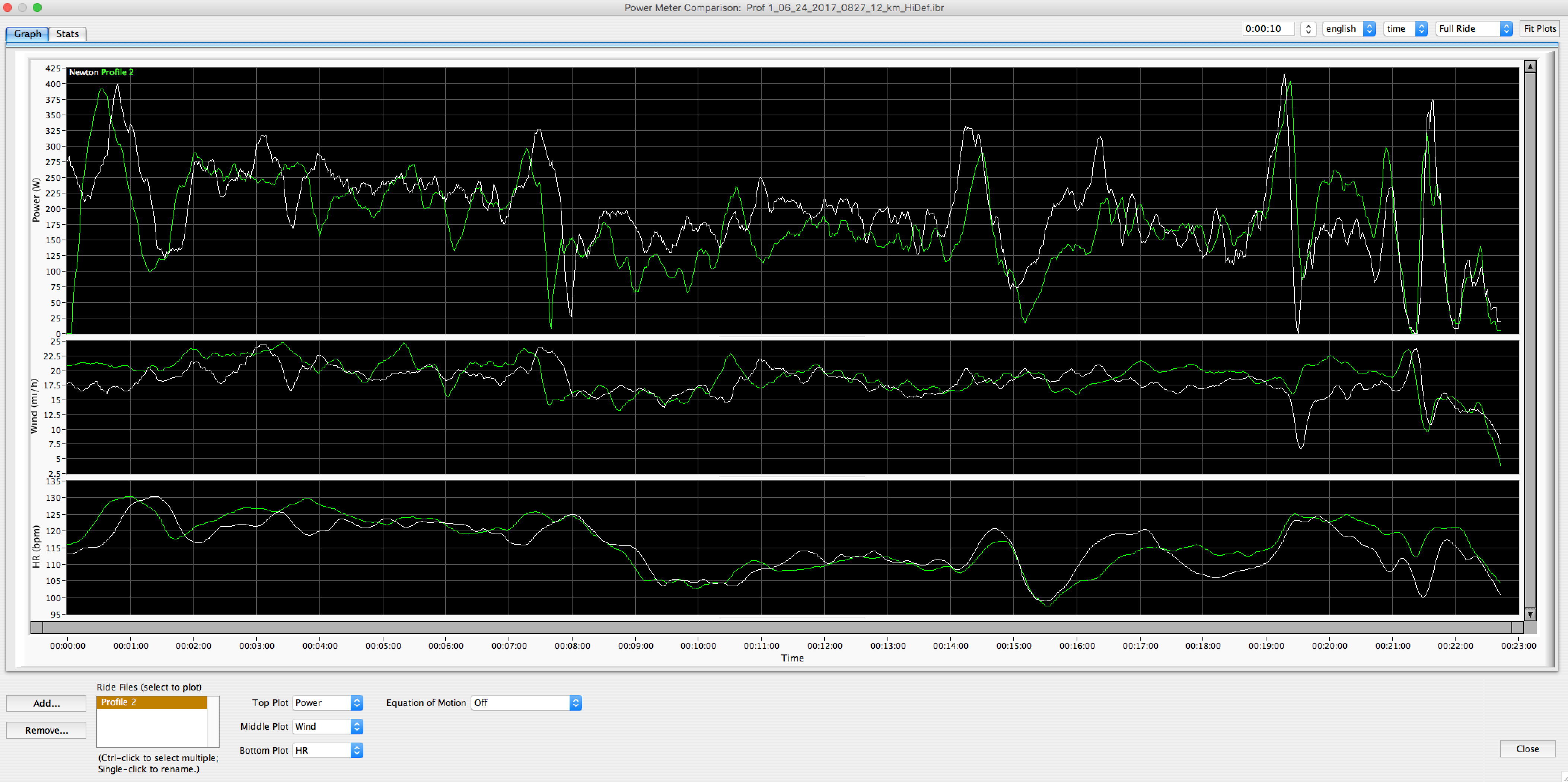

I looked at your ride files.
You've done a very nice job of calibrating each bike, and of controlling your riding so that they are nearly identical to each other.
I removed the first 8 minutes of each ride file, so that tilt calibration would not be a factor.
Because you did such a great job of riding, I was able to use the Power Meter Comparison feature (even though they are two different rides). In some places there is slight misalignment of time, but your eye can fix that...
You're correct that Profile 1 gives higher power numbers--after removing the first 8 minutes, about 20W higher.
But I think this is correct.
If you look at the PMC, you'll see that the riding conditions were close, but not identical. Though you held the same bike speed on both rides, wind conditions were a bit different. Where profile 1 wind is higher, in those sections watts are slightly higher. And note that your heart rate was SLIGHTLY higher on profile 1 ride--suggesting that you were working a bit harder.
I think you've done a great job with both setups. Have fun riding!
