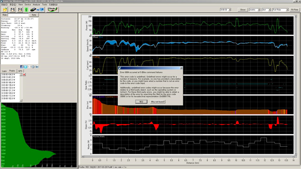

However, if you try to download the data from a few weeks ago, you will not be able to download the data with error message "Error 6004 ~~ [see picture below]".
A. The received PowerPad is good for charging and data transfer, but can not download data from the eSac software after 6004 error message.

powerpod "error 6004~~"
- 1.jpg (208.47 KiB) Viewed 2391 times

It is likely that this particular ride file is corrupted.
Using Isaac do a Device/Erase All Ride Files command. You will lose this particular ride, but you should be OK going forward.
