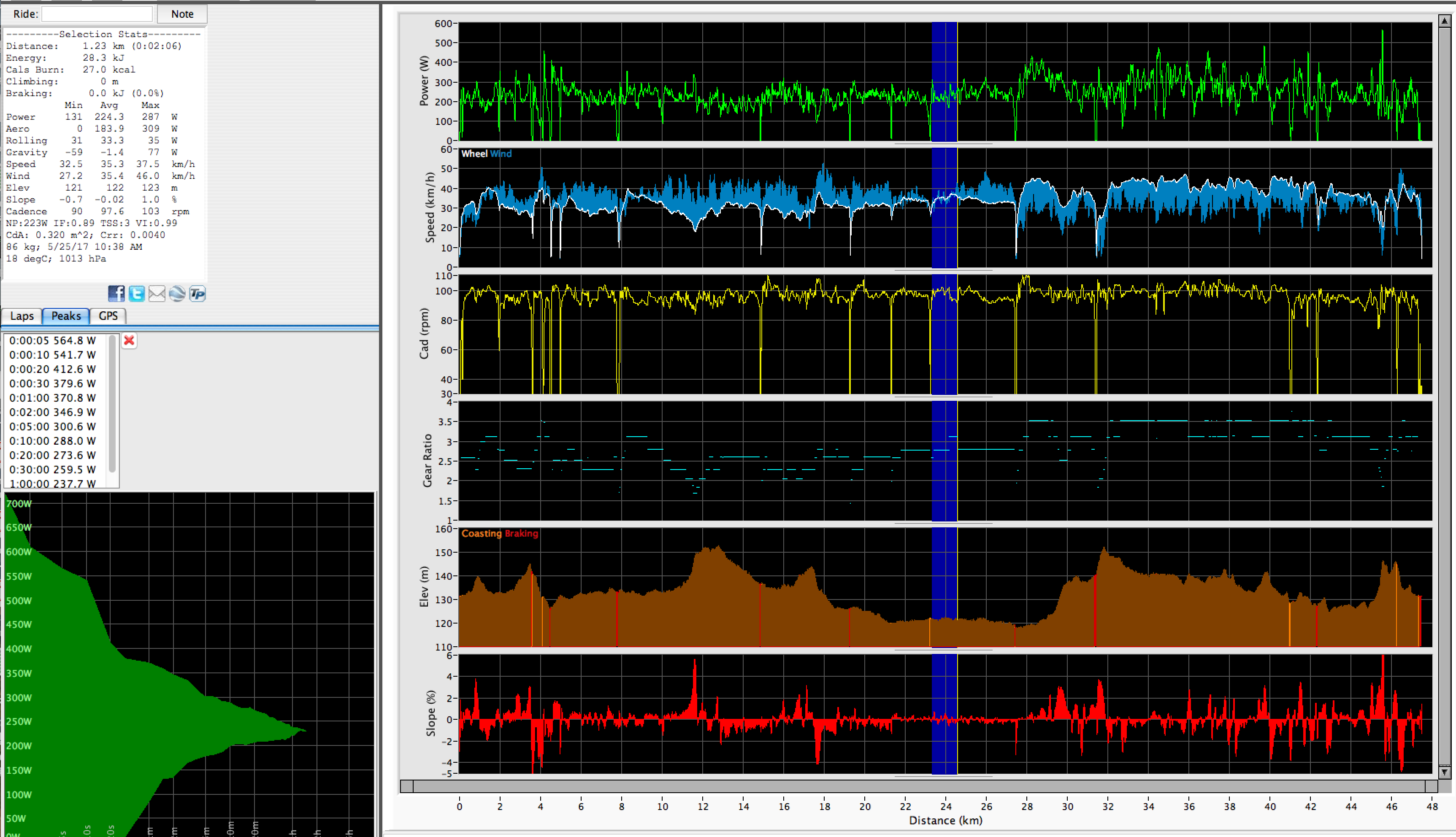

You can't use bike calculator websites in this manner.
Your ride was over a wide variety of wind and elevation conditions. These bike calculators assume that the riding conditions are CONSTANT at all times.
From the Gribble website:
"Remember that the speeds involved are steady-state, i.e., the speed you will be able to sustain under the given power, assuming all other parameters stay constant."
To use bike calculators properly, you need to select short ride segments, where conditions don't vary much.
I selected a short segment, around km 24, where bike speed was nearly constant, terrain was nearly constant. Isaac gives 224W for this segment; Gribble gives essentially the same number.
Your PP is working perfectly
- Screen Shot 2017-05-31 at 9.50.27 AM.png (210.08 KiB) Viewed 3706 times
- Screen Shot 2017-05-31 at 9.51.29 AM.png (685.21 KiB) Viewed 3706 times
