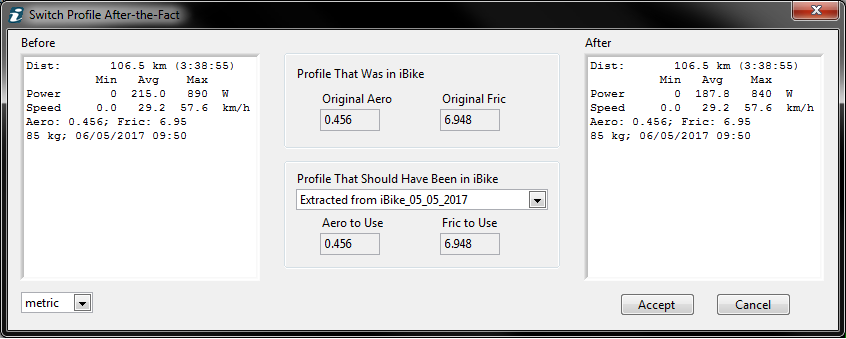

Then I extracted the ride Saturday profile and went to the option of applying a different profile post ride and selected the profile I had just extracted from this ride, which presumably shouldn't change anything, but it changed the average power to 193 W.
I don't get what is going on? I open a ride, extract the profile and then go to apply the same profile and the numbers change.

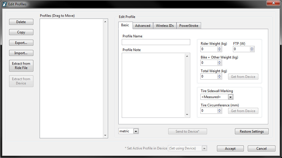

2. this is the edit profile screen with no profiles

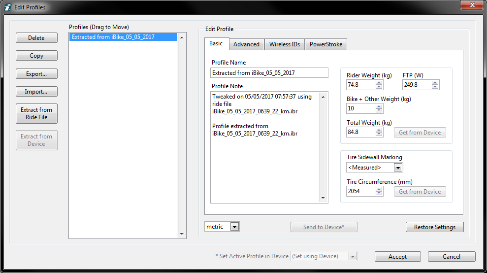

3. this is the edit profile screen after extracting the ride file from the ride
4. this is the switch profile screen showing the Watts changing even though it is the same ride file.
