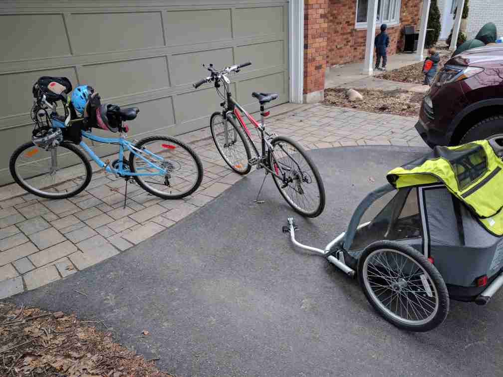

I'm not sure what you mean by a "bike with a trailer".
Please post a photo...
Re: calibration ride
Since I have 3 young children most of my rides consist of a hybrid/MTB pulling a child carrier. I attached a photo.
I saw your reply to a comment about pulling a trailer that you posted on DCRainmaker's review page about simply adding the weight off everything and Powerpod will take care of the rest. That comment is what prompted me to purchase the Powerpod. I figured I could calibrate it for the bike with the kids and when I can ride alone, simply swap profiles and mount on my road bike.
My concern is that surely adding the carrier will affect friction, rolling resistance, etc. That's why I ask how should I go about getting the right calibration for this setup?
The primary thing you'll want to get right is the total weight of your bike + all extras; including weight of trailer and kids!
Rolling resistance will be affected some, due to the two extra tires. But I don't think it will be a huge effect. Your 4/10 ride file has a rolling resistance equivalent to riding in soft sand!
CdA will increase some also
Note that, if you're riding on mostly level surfaces, weight won't be a huge factor except when you are accelerating.
