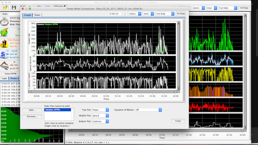

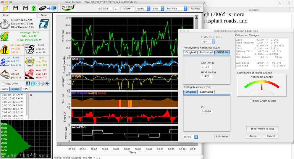

4) Not sure if calibrating the DFPM is related to the above point and needs the DFPM to be paired to the Powerpod - but I have problems. I've followed the pages on the manual as best as I could but the DFPM forces my CdA to be 0.100 which seems too low. Any idea why? How does this feature import the DFPM data? I ask this because I'm assuming that I would have to manually import DFPM data from another file (maybe from my Garmin). Screenshots attached.. 5) I was looking at the Power Meter Comparison feature - what is this feature for and how is this different from DFPM calibration/pairing? There are 2 graph legends: "Newton" and "Newton DFPM", again how is the Powerpod able to incorporate DFPM data into the ride file? Screenshots attached.. Feels like Issac has a ton of features and I really want to learn as much as I can about all of them. Hope you can point me in the right direction..

3) PowerPod receives ANT+ signals. If your DFPM broadcasts in ANT format (almost all do) then PP can pick up its signal, if you have the CdA feature installed. To check if you have this feature, go to Device/Unlock Feature/Check Unlock Status. If you see the CdA feature there then you can record DFPM data in your PP
4) Yes. Something is wrong; don't use 0.100...
Please post the ride file and I will take a look.
