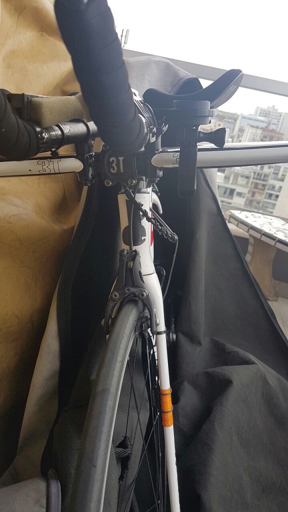

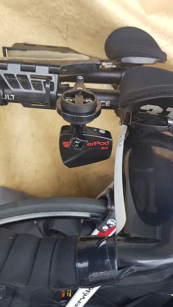

Your wind readings are incorrect, causing low watts.
Please post an image of your PP mounted on your bike. Is it possible your wind sensor is located near cables or some other obstruction?
kdx200
Posts: 188
Re: wind effect, low power, weak legs, tired body?
Post by kdx200 »
strange... i did not touch the PP since the first time you told "its ok".
get a look.
thanks!!!
