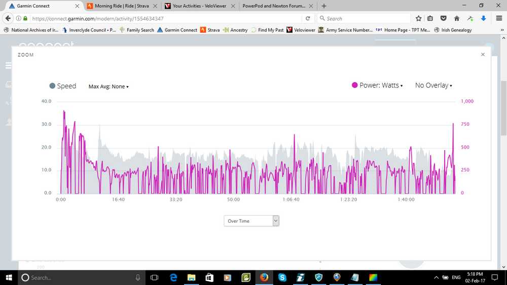

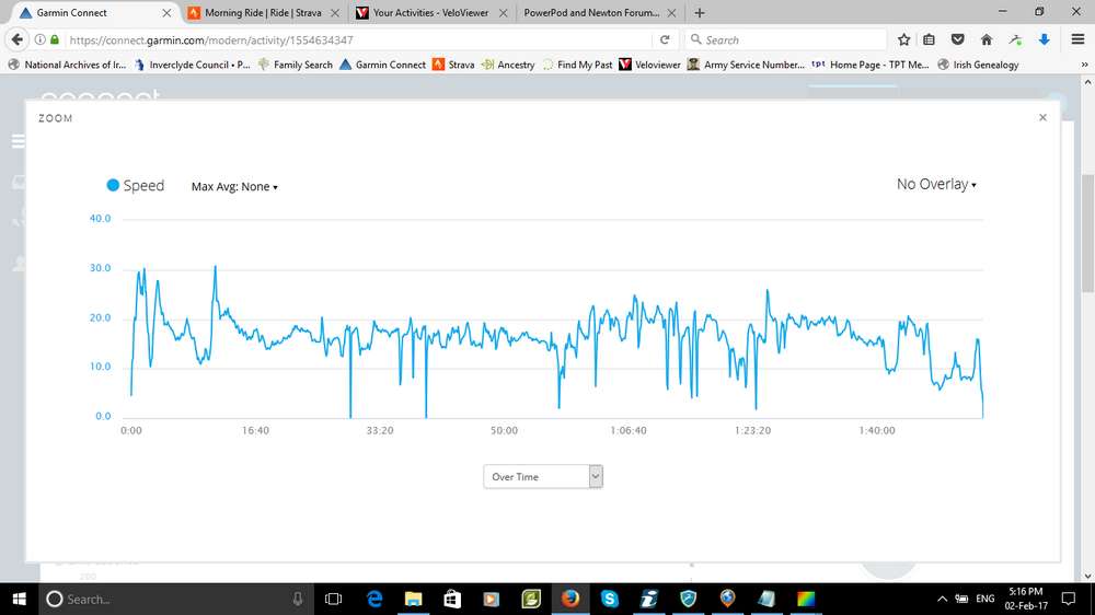

Today I've completed a regular 31.5 mile ride however when I've uploaded the data to Isaac the file name is suffixed "18" miles and the ride file records 22.72 miles. Total ride time is also different. The Powerpod data also records many speed dropouts. These dropouts are not seen in the data from my Garmin head unit.
I've attached the .ibr file together with images from Garmin Connect - one the clean speed graph and the second with the power data as an overlay. Interestingly Garmin Connect has recorded power over the 31 miles distance.
Would it be possible to review these and advise why there are time and distance discrepencies and so many speed dropots in Isaac but not in Garmin and how to resolve.
Speed graph with power overlay

Clean speed graph
Clean speed graph
Garmin speed 02 02 2017_1.jpg (41.01 KiB) Viewed 4045 times

Re: Help with Powerpod data
Your ride file shows a lot of speed sensor dropouts. This is what is causing your shorter ride file.
It looks like you're using a GSC-10. Sometimes these work well and sometimes they don't. We do not recommend them.
If you get a magnet less speed sensor for your front hub this problem will disappear.
