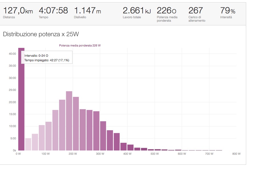

This is today's output graph unfortunately done so in the group can not use it to make the calibration What do you think? are not a little too many times when the power is 0?
Schermata 2017-01-25 alle 14.55.55.jpg (64.07 KiB) Viewed 8059 times
iBike_01_25_2017_0841_128_km.ibr
Strava power zone
(833.35 KiB) Downloaded 295 times
Re: First ride with POWERPOD downhill plain Problems with th
Your ride file looks fine.
Overtime you stop pedaling, cadence goes to zero and so does power. Since this is group ride, you will do a lot of start-stopping. So your zero power is normal.

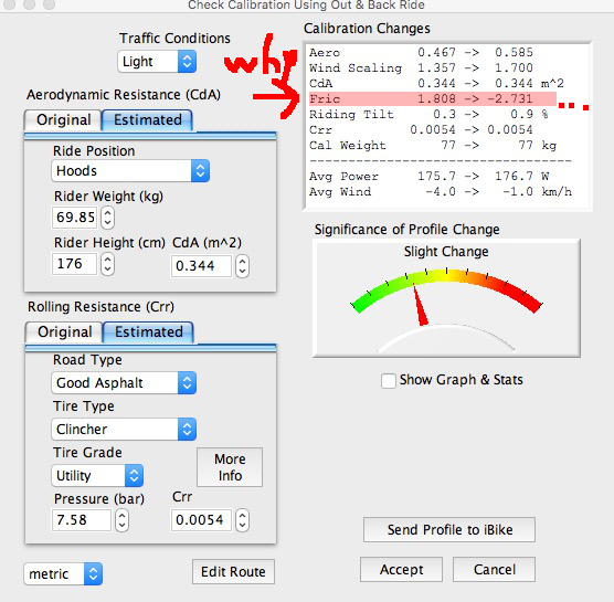

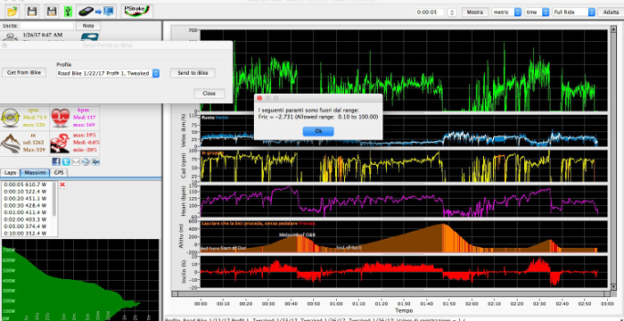

Today I made a new turn, a measure of power in salit it seems a bit overestimated, got home, I tried to use the output file today to calibrate the POWERPOD but there was a problem with Fric value that is out scale (is negative) it depends on what?
Schermata 2017-01-26 alle 13.35.08.jpg (281.08 KiB) Viewed 8037 times
iBike_01_26_2017_0847_73_km.ibr
(620.81 KiB) Downloaded 280 times
Frankly, I see nothing wrong with your ride file. You are climbing some steep hills and you are a strong rider. Enjoy!
It looks like you did some drafting in this ride; if so, Check Calibration will NOT work.
I would leave things alone and go ride...

The watts calculated is too high compared to what other powermeter have found today and also with respect to the ambrosini formula with the necessary approximations of the case. Because I got a fric negative value?
Schermata 2017-01-26 alle 16.38.48.jpg (200.85 KiB) Viewed 8029 times
I don't know why this particular correction is being proposed.
What I do know is that you should NOT change your profile, so this correction is not an issue.
