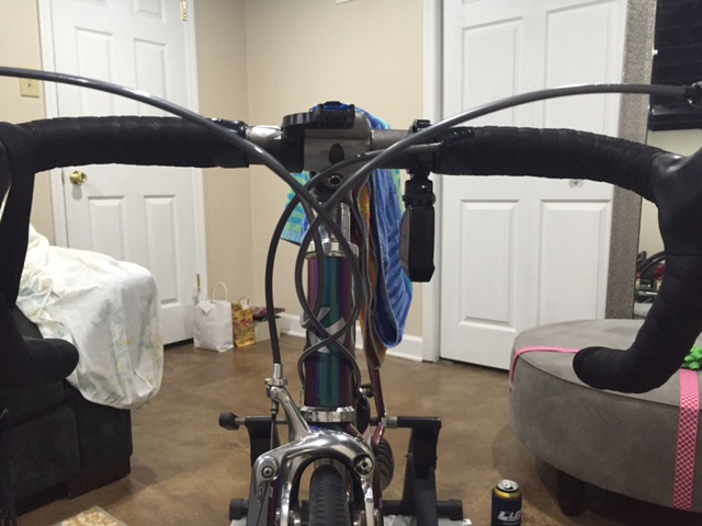

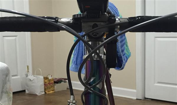

Hmm...please post photos of your PowerPod attached to your bike: front and side views.
Wind reading is too low.

See front and side pictures. Is that cable in the way too much?
Looking at it now I might should move it out further.

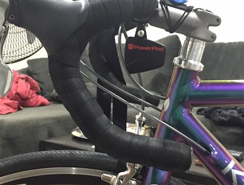

I decided to move it out further on the handle bar. I try and get a ride in and post the new file.

Re: First PP Ride Review
I'm glad you moved it. The cables may have been inhibiting wind.
