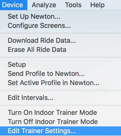

Here is what to do:
1) connect your PP to Isaac
2) get the curve you want from powercurvesensor
3) In Isaac, use the command Device/Edit Trainer Settings...

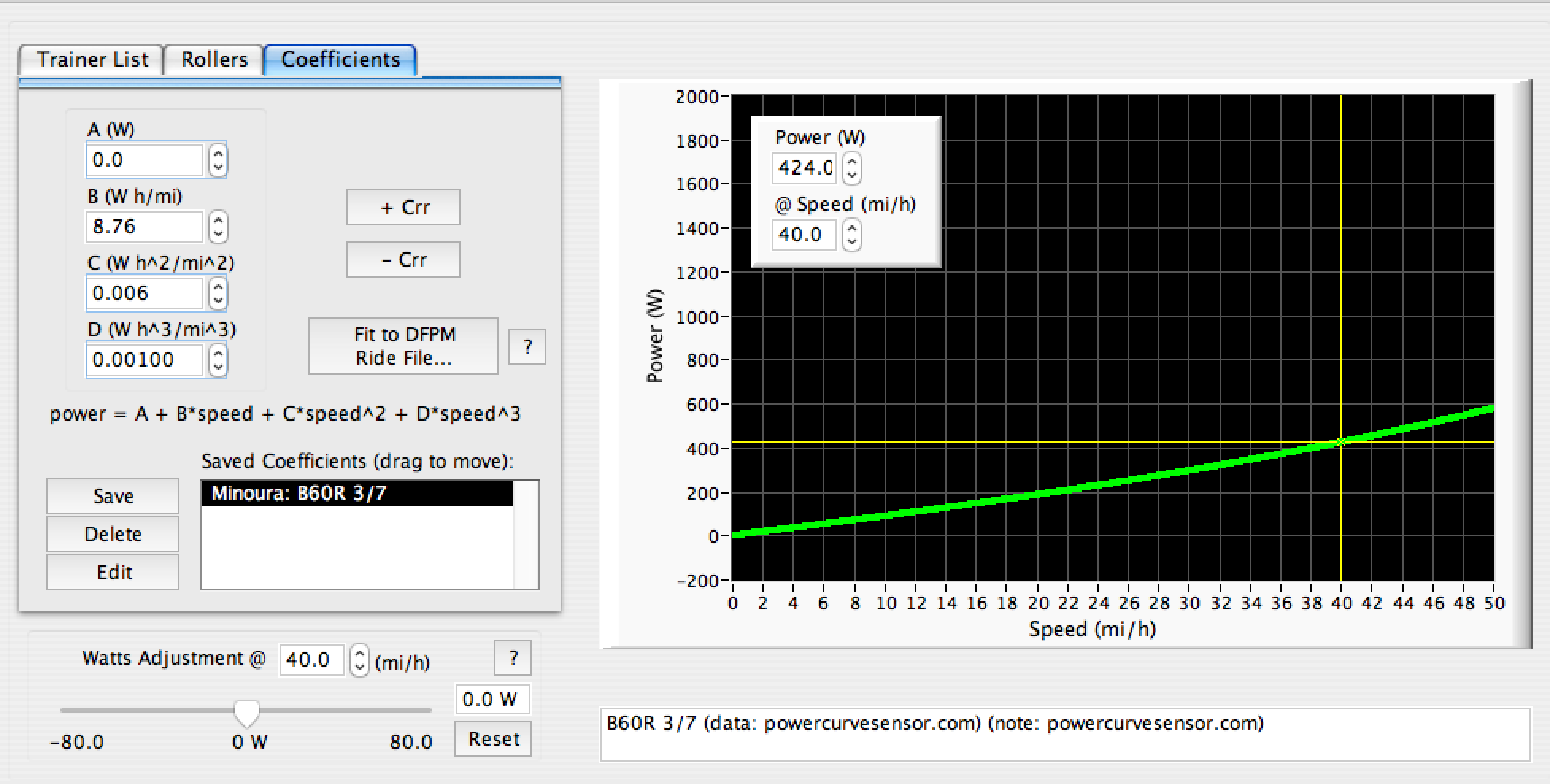

4) When the window opens, select the Coefficients Tab
Screen Shot 2017-01-11 at 9.06.38 AM.png (162.71 KiB) Viewed 17490 times
5) The coefficients and curve you see will be for whatever trainer happens to be selected on the trainer list; THESE COEFFICIENTS ARE WRONG FOR YOUR TRAINER
6) Enter the curve fitting coefficients that best fit the speed/power curve for your trainer (you can play around with this manually, or find a curve fitting routine for cubic polynomials). I have done this for the Minoura B60R 3/7 curve

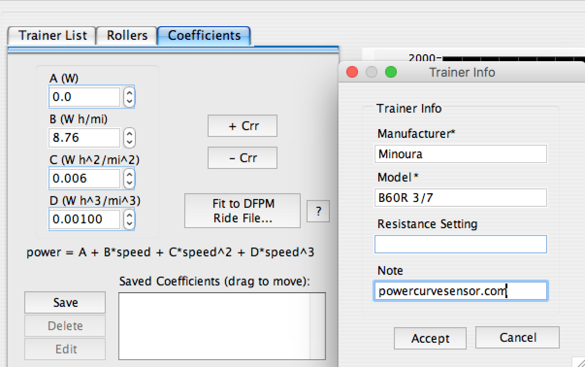

7) Click the Save button; a pop window appears where you'll enter the name of your trainer curve
Screen Shot 2017-01-11 at 9.10.10 AM.png (121.14 KiB) Viewed 17490 times

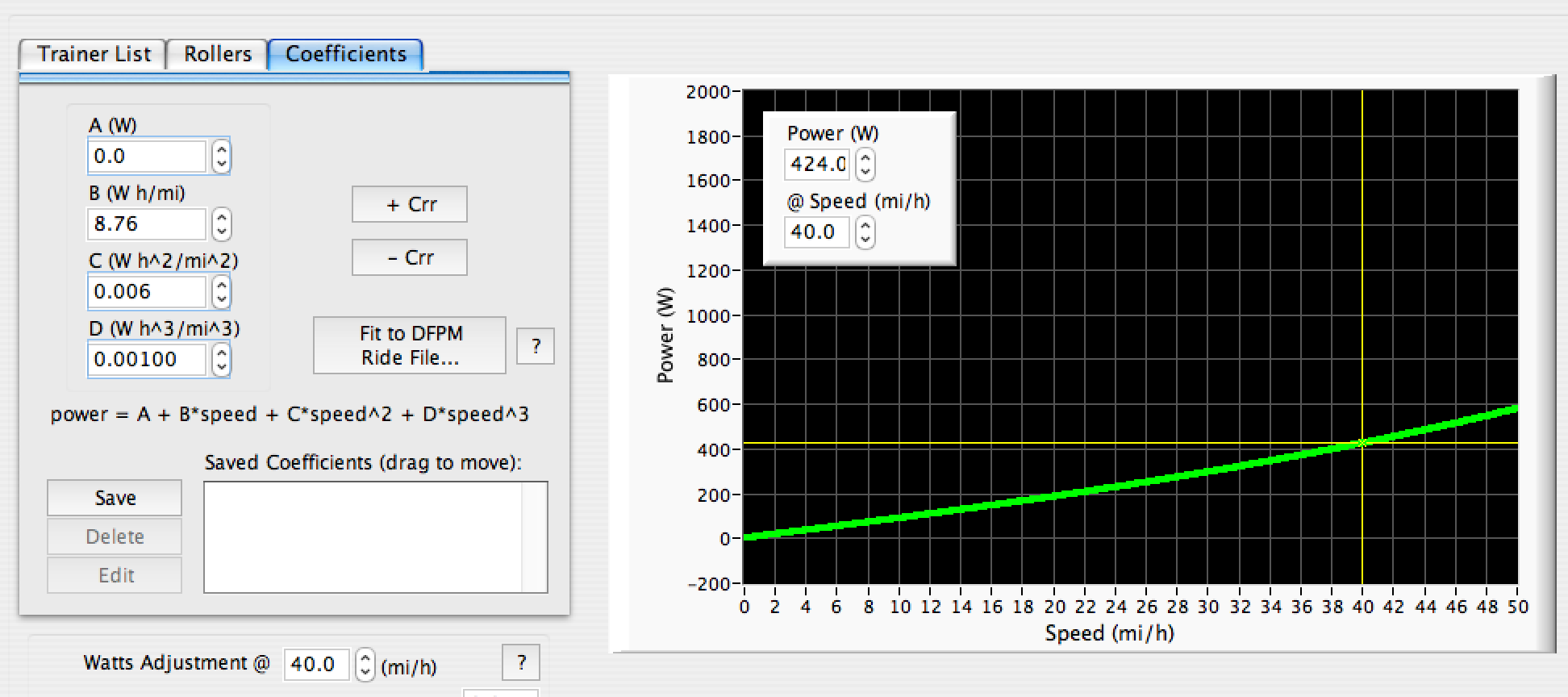

8) Click the Accept Button; the new trainer will now be saved in your Saved Coefficients List
Screen Shot 2017-01-11 at 9.11.07 AM.png (185.89 KiB) Viewed 17490 times
9) Finally, click the "Send to iBike" button to transfer the highlighted trainer curve to your PowerPod

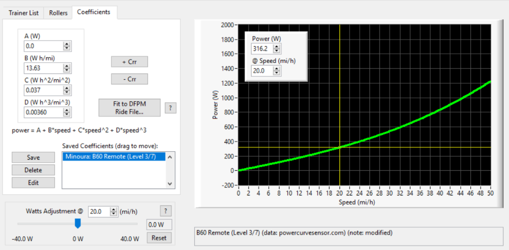

Really useful thread to stumble across what with how the world is currently on lockdown! Figured I'd finally try out my PowerPod with my Minoura B60 (remote) "dumb" turbo trainer.
One observation though..... I think the coefficients shown above are a bit out of whack due to not converting the power curve data (source: http://www.powercurvesensor.com/files/37c.png) from kph to mph. So I re-calculated the coefficients (using https://mycurvefit.com/) , and thought I'd share those coefficients here in case they are of use to anybody else.
Minoura B60 Remote 3of7 Power Curve_Isaac.PNG (155.42 KiB) Viewed 15330 times
