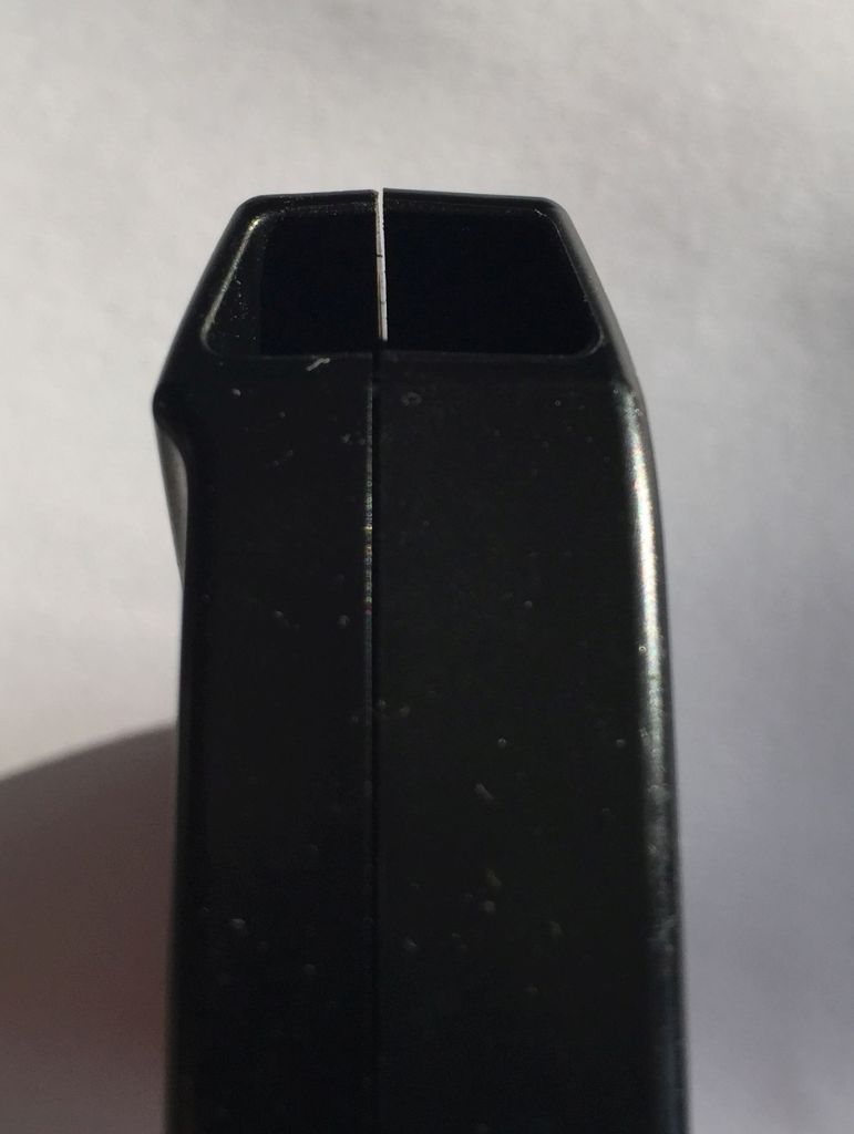

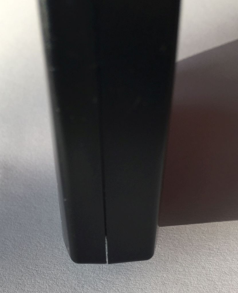

The weird power readings I get during the ride appear to relate to the wind direction. So today I checked the wind port of the Powerpod. I noticed that the underside of the Powerpod (under the port) is not completely closed. The ‘seam’ on the underside is not completely closed under the wind port. See attached pictures. Is that normal? And if not, could that explain my problems?

And here are the pictures of the 'open seam' on the underside of the Powerpod.
- Powerpod underside.jpg (65.27 KiB) Viewed 6761 times
- Powerpod front view.jpg (43.77 KiB) Viewed 6761 times

I also have that "open seam".

I'm curious to see what the Velocomp folks might say about that open seam. I could seal mine up easily enough with Sugru or the like if needed.

By design we leave a small gap in the wind port. This helps drain water that might enter it.
If you want to test the effect of the gap, do a short ride, download it, then put a piece of tape on the outside of the case, where the gap is. Do the same ride again and download it.
