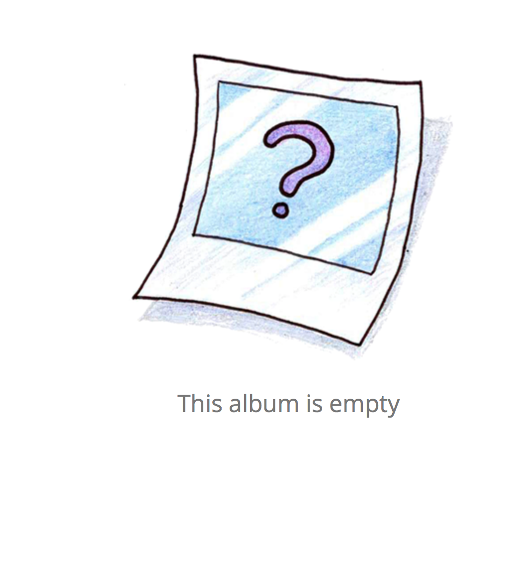

Heres a picture...Powepod label on side isnt parallel with ground but air inlet is.
https://www.dropbox.com/sc/qyf8l60fin13 ... AzwNFjsBQa
Re: power way off
Album is empty...
- Screen Shot 2016-10-05 at 8.06.15 PM.png (531.8 KiB) Viewed 4785 times
Re: power way off
Aha! As suspected...your PowerPod is pointed way too high in the air.
The word "PowerPod" should be approximately level. When pointed so high towards the heavens you'll get weird readings.
Reposition your PP as recommended, ride for 8 minutes, then post another ride file. You should have much better results.
