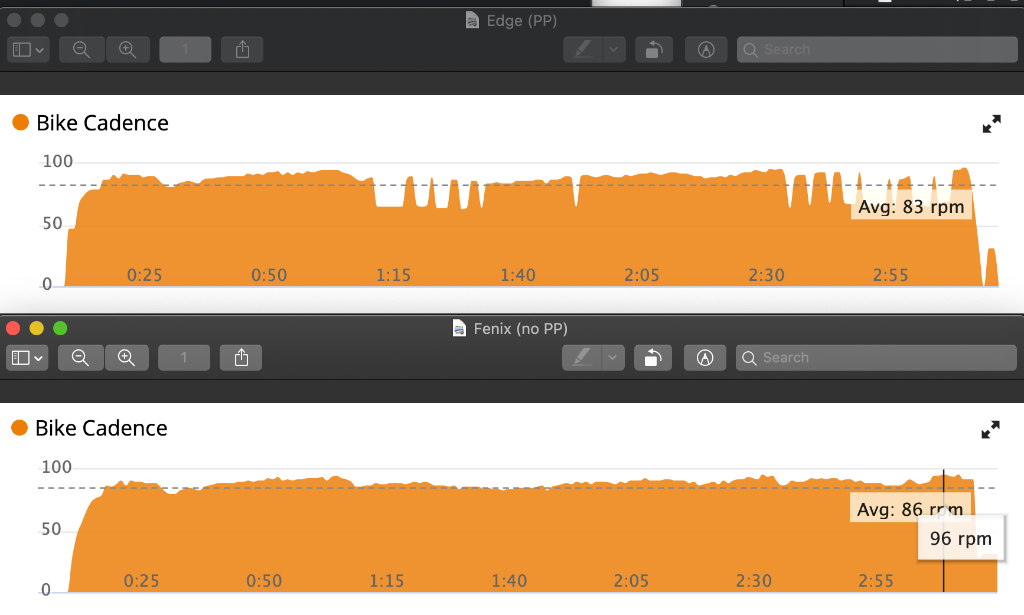

Just re-paired my PowerPod with my cadence sensor. Also paired my Fenix 6x with my cadence and speed sensors (not the PP). Paired my Edge 830 with the cadence and speed sensors as well as the PP. All devices have latest firmware as of today.
As you can see in the attached Garmin Connect images and .fit and .ibr files, the device connected to the PowerPod is the one showing an issue (also visible in the .ibr files); the same cadence source going to a device not connected to the PP shows a normal signal.
Screen Shot 2020-09-30 at 3.14.49 PM.png (202.73 KiB) Viewed 17516 times

Re: Powerpod V3 causing drops in estimated cadence
Thanks...this is the data we needed.
What's frustrating about this problem is that we can't replicate it. I am using the same sensor setup, paired with an Edge 520. No problems...
We will find out what is going on in our firmware and get this fixed.

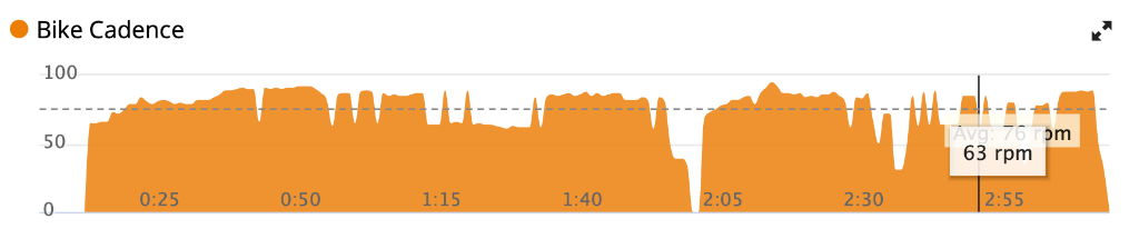

Tried one more thing: I disabled the cadence sensor on my Edge (to verify whether or not the PowerPod was indeed transmitting cadence). Did another lap: cadence data showed and recorded, along with the drops. So yes, the PowerPod does transmit cadence.
Screen Shot 2020-09-30 at 3.53.48 PM.png (38.23 KiB) Viewed 17511 times

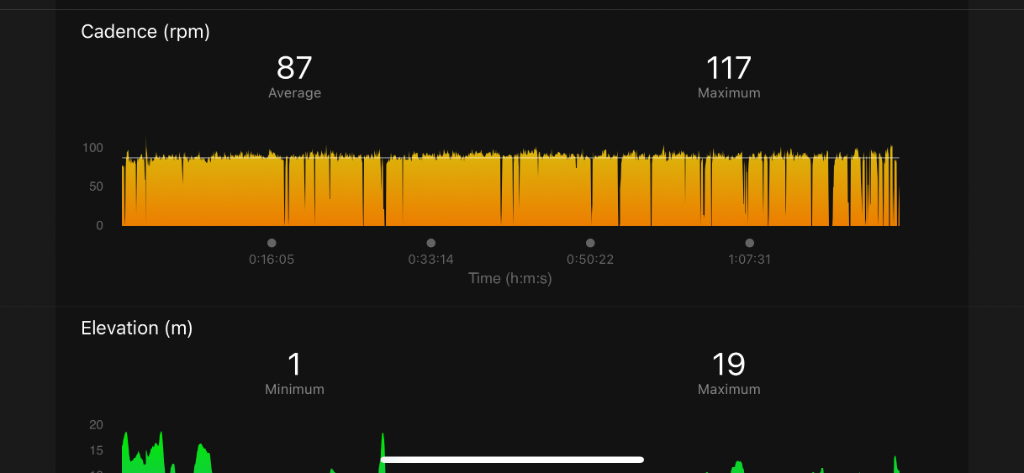

Just to add, I’m using an edge 1030 Firmwatlre that came out late sept 20 - 10.5 I think?
Earlier this week - computer paired to cadence sensor and appears PP also paired to same sensor. Despite garmin showing connected to the sensor for cadence and despite the earlier post saying something about torque and priorities (incidentally the garmin forum post was a completely different setup so irrelevant) my Edge was overriding the Paired sensor with the PP cadence stream.
Rode this morning without PP and no drops at all. - see piccy.
So until FW fix, it seems the only way is to do a repairing for just speed sensor to PP then pair everything else to the garmin units.
I tried same cadence sensor on fenix and no issues there either.
