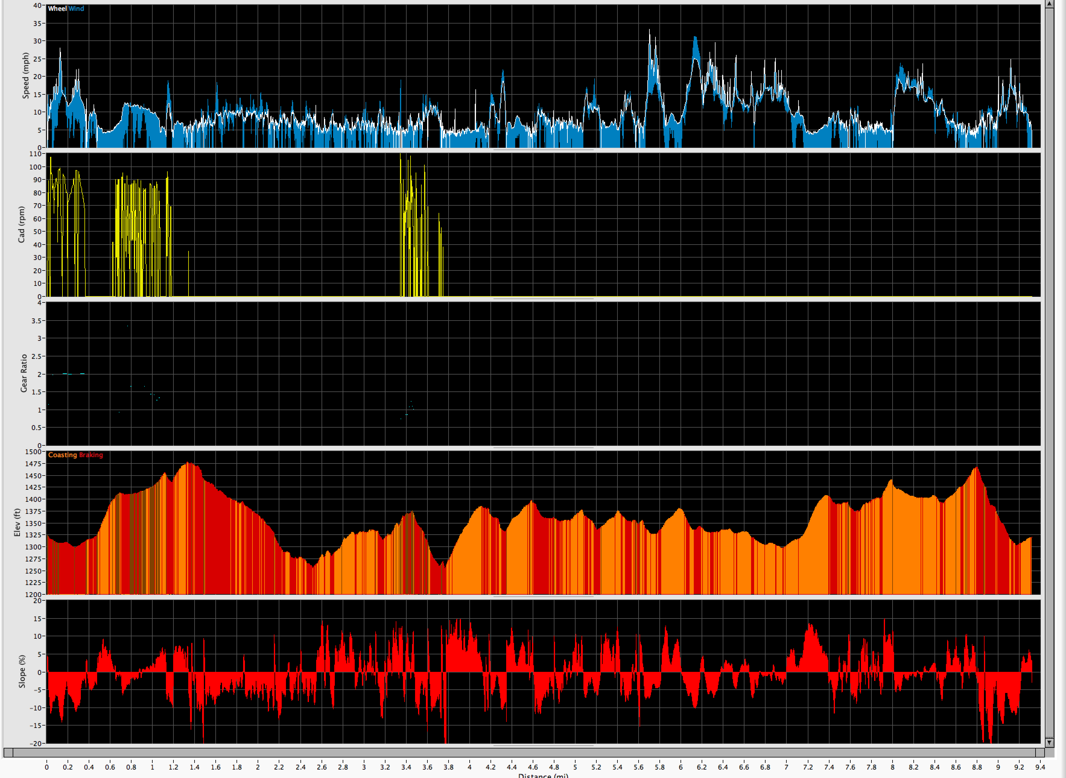

I seem to have hosed something up. I went for a ride today, normal mountain bike terrain, fire roads, single track, etc. and was getting very crazy readings from the PowerPod. I have attached the file, if you could take a look and let me know what's up, I'd appreciate it. I modified the wheel size setting in the profile and sent it to the PowerPod.
- iBike_12_27_2016_1434_10_Miles.ibr
- (228.67 KiB) Downloaded 728 times
Re: Anyone using PowerPod on a Fat Bike with any success?
Your speed and cadence readings are very, very intermittent.
This is the cause of your problems.
It looks like you are using a Garmin GSC-10 sensor; if so, please get a new magnet-less sensor, and install your speed sensor on your front wheel hub.
- Screen Shot 2016-12-27 at 6.53.57 PM.png (900.62 KiB) Viewed 24363 times

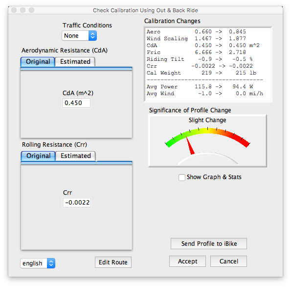

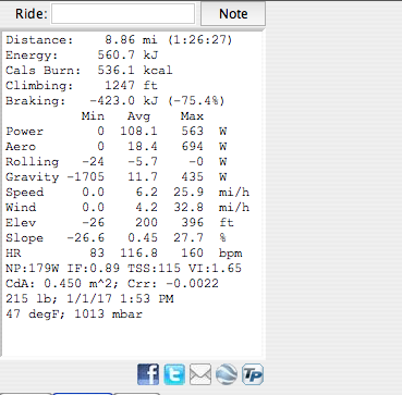

So, I went out yesterday on a fatbike ride having used the "Edit Profiles... - Send to Device*" function in the Issac 4.0.0 software to make the following profile active on my device prior to the ride. The core values for this profile were created during a previous calibration ride. Some values were "tweeked" using Issac's "Analyze - Check Calibration..." menu commands. You will note that the Crr in the profile is listed as 0.0172 (again, calibration ride generated):Velocomp wrote: ...One statement made in the thread incorrect: Crr does NOT "go negative" during a ride. What I think was happening is something to do with the calibration of the unit, or perhaps its mounting angle on the bike. I won't be able to tell until I see the ride file.
After returning home, I connected my device to my MacBook Pro and downloaded the ride file. You can see the screen result below (would have included the entire Issac file window, but it was too large to import):
You will note that the value for Crr now says that it's equal to -0.0022, the negative value that I've been reporting in past posts (and that has happened numerous times, covering a variety of mounting setups). This screenshot was taken immediately post-download and includes no Issac-related post-ride processing. Although it seems like there was a time when Crr and the other values related to the Aero and Friction Calcs could be viewed from the Newton itself (to confirm the "current" values), regrettably, I've been unable to see a screen(s) devoted to these data using firmware 5.13, which I believe is the latest version compatble with my device. Therefore, I can't say when the Crr was changed from 0.0172 to -0.0022, but -0.0022 is the value displayed in the Issac window immediately post-download.
So, while I fully understand that Crr shouldn't become a negative number, in this case, it has "...gone negative." I ask again: What's the explanation for this behavior? I've attached the ride file below:

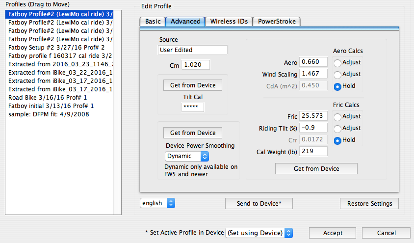

Please do the following:
1) Import the attached ratmanCrr profile into Isaac. This profile has a value of 0.172 for Crr
2) Load this profile into your Newton.
3) Use the "Edit/Edit Profiles/Get from Device" command to confirm that you have loaded the "ratmanCrr" profile with Crr = 0.0172 into your Newton.
4) Do another ride
5) Download the ride, then post here
This ride file should absolutely have the correct Crr in it. If not then something very weird is going on that has nothing to do with a fat bike!

1) In the portion of the Issac ride file window that I posted in my last note, the line reporting wattage attributable to "Rolling (resistance)" reads: Min = -24, Ave = -5.7, and Max = -0 Watts. This would seem to mean that the Newton "saw" all of the roots and rocks that I encountered during the ride (and there were many, believe me!) as making the effort easier (negative watts, right?)!
2) Surpringly (to me, at least), the Issac "Analyze - Check Calibration" screen on this (raw) ride file doesn't provide a suggested change for the Crr = -.0022 value (see screen capture below). I don't know if Issac "locks" the Crr value during this processing. However, checking back on the Edit-Profile screen that I submitted in my previous note above (i.e., the pre-ride profile that I loaded), the Aero (0.660), Wind Scaling (1.467), and Tilt (-0.9%) values in the "pre-edit" column remain unchanged, but the fric value was changed from 25.573 to 6.666 (why??). This also seems to indicate that something is dramatically wrong. What do you think? (Note: the listed weight change from 219 to 215 was a change that I did make after the screen capture -- no mystery there).
I'll load the "ratmanCrr" profile onto my device so we can doubly assure that Crr = .0172 is being used by my Newton (although, as I described in my previous note, this would have been the case already if Issac had successfully loaded the aforementioned profile as I had instructed it to do prior to recording the ride file in question). That will be a good double check -- perhaps the profile on my end is corrupted. I'll post the subsequent ride file for your further analysis. It may be a week or so before I can do that, though, as several issues are going to be getting in the way of my riding.
As you state, this problem may not have anything to do with the fact that I'm riding a fatbike, per se. My concern, however, is that it may be related to the relatively extreme calibration values (specifically Crr and fric, which I realize are related) that could be appropriate for fatbikes. Could they be causing some internal calculations to yield errors? Are the Crr and/or fric values interrogated and forcible changed at some point to ensure that they are within "normal" limits, limits originally conceived of for road bikes?
Thanks for your assistance -- I'll be following-up as requested with the post-update ride file.
The profile used during a ride is set BEFORE the ride, and remains constant during the ride.
The weird rolling watts you remark on is because your Crr was negative during the ride. Again, this is configured prior to your ride, so the profile was wrong.
I do not see any reason a "fat bike" configuration would cause this mystery.
OK, I simulated a fat bike set up. Here is exactly what I did:
1) I extracted my Newton profile 1. Profile 1 has been calibrated for my road bike (Crr = 0.004)
2) In Isaac I edited my profile 1, using "ratman" parameters (weight and Crr; CdA is irrelevant). I named this profile "ratman/JRH"
3) I switched to profile 2 in my Newton
4) I transferred the ratman/JRH profile to profile 2
5) I confirmed that the contents of profile 2 had the correct Crr
6) I then did a short ride
7) I downloaded the ride and confirmed that the Crr was 0.0172, as expected (by the way, watts are much higher than road bike watts; fat bikes make you work harder
Based on my little experiment, I see no reason that fat bike parameters should cause Crr should go negative.
I think the key here is to make sure to reset the Crr AFTER the Newton has been calibrated on the bike (i.e. you have cycled with the Newton on your bike for at least 8 minutes).

1) When you say, "3) I switched to profile 2 in my Newton," do you mean that you chose Profile 2 in the Issac "Edit Profile - Set Active Profile in Device" dropdown field before clicking "Send(ing) to Device," or did you choose the Profile 2 setting on the Newton itself?
2) When you say, "5) I confirmed that the contents of profile 2 had the correct Crr," are you looking at the profile in Issac (Edit Profile-Advanced), or directly on the Newton?
3) I asked once before, and I'll ask again: Is it possible to view the current Crr and other ride calibration values directly on the Newton? This would be the ultimate way of confirming the current "onboard" values. It seems like that was once possible, but I can't find the screens currently...
4) You said, "I think the key here is to make sure to reset the Crr AFTER the Newton has been calibrated on the bike (i.e. you have cycled with the Newton on your bike for at least 8 minutes)." I've now done about a half dozen rides (covering hours on the saddle) with the Newton mounted in the current configuration. Does that mean that if I load the ride file you posted for me at this point, I've complied with this "key point?"
1) I'm not implying that anyone is doing anything "wrong". I completely accept that something peculiar is going on. We are both trying to figure out what it is
2) Analyze-Check Calibration is a feature whose primary purpose is to correct wind scaling. If Analyze-Check Calibration is messing up your profile Crr, then something may be wrong with the Analyze function. Therefore, for the time being I would NOT use Analyze-Check Calibration in this testing.
3) I will do a bit longer ride and try the Analyze function. We'll see what happens!
4) I used Isaac to switch to profile 2. This can also be done in Newton setup. It doesn't make any difference which way it is done
5) I confirmed the profile by having the Newton connected to Isaac, then using the command "Edit/Edit Profiles/Extract from Device"
6) Crr is not displayed on the Newton screen
7) Please do a ride with the "ratman" profile, then post the ride file afterwards, making sure that no post-processing of the file is done.

I think we need to start with a "clean slate" for your Newton:
1) Attach your Newton to Isaac
2) Use Isaac to set your Newton to profile 2 (or some other profile that you don't use). "Device/Set Active profile in Newton..."
3) For the profile you have selected, use the command "Device/Setup/Reset Profile-Device..." and click the "Reset Profile x" button ("x" is the profile number you selected in step 2)). This will restore profile "x" to factory condition. After reset you'll see that in the "Edit Profiles/Advanced" tab, the "Tilt Cal" window will say "empty"
4) Pair up your sensors. BY THE WAY: your speed sensor readings are somewhat erratic. If you're using a magnet-less sensor, put it on the front wheel hub. IMPORTANT: after pairing go into setup, and confirm that your Newton is set to profile "x" (the one you've cleared out).
5) Next, in Newton Setup, select the "Cal Ride" function; then, perform an out-and-back calibration ride. The cal ride will set the wind and tilt parameters of your profile. IMPORTANT: if your fat bike fork has a lockout suspension option, make sure you lock out the fork during the cal ride.
6) Download and save the cal ride. The ride file should end in "...calride.ibr"
7) After the cal ride use the Edit/Edit Profiles function to extract your profile from your device. You should see 0.0054 for the Crr, and the Tilt Cal window should say "*****" (tilt cal was measured during the cal ride).
8) Click the radio button next to "Riding Tilt". Riding Tilt will now say "Hold", and "Crr" will be adjustable. Adjust Crr to 0.0172, then click "Accept".
9) Open "Edit/Edit Profiles" window, make sure the profile you've just changed is highlighted, then click the "Send to iBike" button. A confirming message will appear.
10) Do a ride with your new profile.
11) Download this ride
12) Post the cal ride file and the ride file after profile adjustment.
If the Tilt Cal number of your original profile is corrupted, it could force Crr to be negative. With a new profile and cal ride of the above steps, hopefully Tilt Cal value will be correct and your Crr will be OK
We will find out...
We will find out...
Ratman

I've just followed the first three steps, and they seemed to go as expected. Under Step 3, though, when I check in the "Edit Profiles/Advanced" tab, the "Tilt Cal" window says, "*****," not "Empty." I was going to redo Step 3 for Profile 3 (my selected Profile that I haven't been using), but I accidentally clicked, "Device/Set Active Profile in Newton...," and I noticed that it had Profile 3 pre-selected, and described it as being set to "Factory Default."Velocomp wrote:I think we need to start with a "clean slate" for your Newton:
So, is it OK to proceed with your instructions, or is something wrong? Why am I not seeing "Empty" in the "Tilt Cal" field? Thanks.
To quote from an old TV show (this will date me, for sure...)
"Danger, Will Robinson!"
I'm not sure how many profiles you have active on your Newton, but unless you are start with a profile with an "empty" tilt cal, your new testing won't be meaningful.
Just to keep everything as safe as possible, I would recommend resetting all four of your profiles individually, using the instructions provided previously. You will lose any profile information already stored in your Newton (you can restore them later on) but your Newton won't have any chance of being anything other than in factory mode.
After you've reset your profiles, you should see "empty" in the tilt cal window of all four profiles. This is essential.
Then, follow the steps outlined in the previous post.

Maybe I'm looking in the wrong place to confirm this. I've reset all four profiles individually as instructed. When I view the profiles listed under "Edit Profiles," two of the entries show "Empty" for Tilt Cal, but the remaining ones (8 or 10 others) still show asterisks.Velocomp wrote: After you've reset your profiles, you should see "empty" in the tilt cal window of all four profiles. This is essential.
Where should I see "empty" listed?
After resetting the profiles, go to "Edit Profiles" and click the "Extract from Device" button. This will show what is stored in your Newton. All four profiles should say "Empty" in the tilt cal box.
Ratman
- Posts: 92
- Joined: Fri Jan 11, 2008 11:37 am
- Location: North Plainfield, New Jersey (USA)
- Contact:
All 4 profiles said "Empty" after the four resets, so I was able to do the cal ride per your instructions. The Crr doesn't look right, but I'll let you analyze the file:Velocomp wrote:After resetting the profiles, go to "Edit Profiles" and click the "Extract from Device" button. This will show what is stored in your Newton. All four profiles should say "Empty" in the tilt cal box.
Should I continue? If not, what are the next steps? Thanks.
WE FOUND THE CAUSE OF THE PROBLEM!!!!
There is an old, obscure limit in the firmware, from 10 years ago, that forces Crr to a crazy value when the user's friction input is too high.
With fat bikes and some MTBs, the user friction input is correct but beyond the internal limit of the FW.
So, we will be issuing a FW update to fix this problem.
This is an "edge case" but we are glad to find this improvement.
