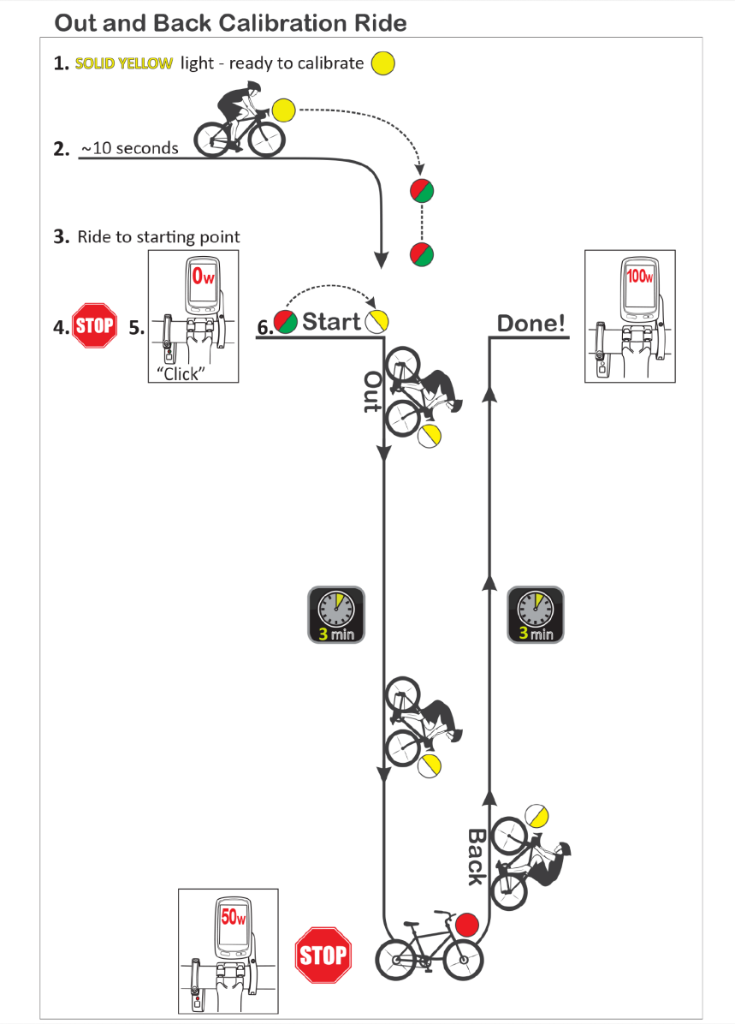

Hello,
during my session today, the pod was connected correctly. For the first few meters, the display seemed to be working, but then it got stuck constantly at 50 watts. The pod was flashing red and green. Later, I installed the Velocomp software on my computer (I had Isaac installed previously). Unfortunately, I couldn't find any error message corresponding to the red/green flashing. I have now completely reset the pod and will test it again over the next few days. Sorry for taking up your time and effort.

Your device was in calibration mode (flashing red/green). You will need to complete a cal ride. See the attachment for details:
PP O&B 6.41+070919-2.pdf
(2.83 MiB) Downloaded 5 times
