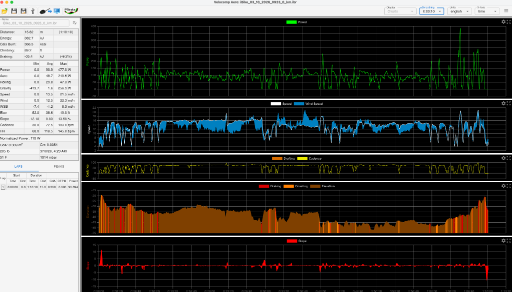

I hope you can find something. I'm currently having the same problem; I can't download the latest tour data. It says there isn't any available, even though I did two rides today. I'm really at a loss.
iBike_03_10_2026_0923_0_km.ibr
(204.47 KiB) Downloaded 12 times

Sorry for the delay in responding; I was traveling.
The ride file you posted looks completely normal to me; your unit is properly calibrated and watts are correct.
