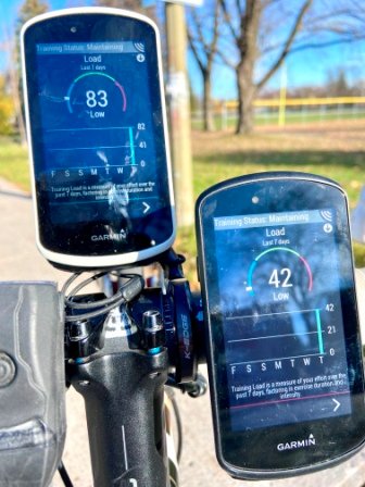

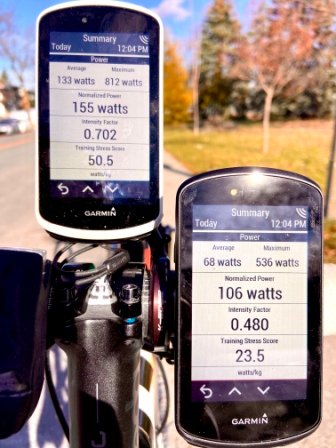

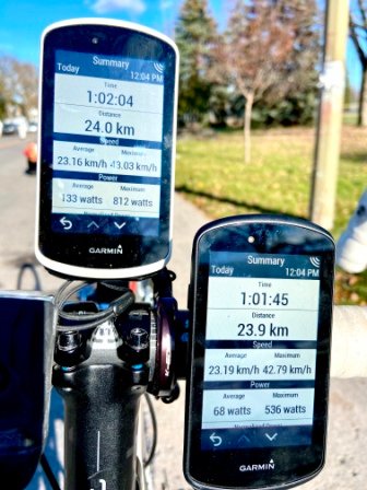

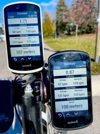

I was constantly under the impression one of my PP's was under-reporting power values - but was chalking it up to less riding, de-conditioning etc.
Until I got a pair of Assioma pedals - just for fun and for comparision.
Wow. "Knowledge is Power" (Sir Francis Bacon).
Now I definitely know that I was putting out more power than the PP was reporting, while before I was oblivious - even though my gut instinct was that the power values reported by this PP were off.
I tested it today and have attached post-ride pics of 2 Garmin head unit summaries, showing the differences. (Note: Upper L unit is Assioma pedals, lower R unit is the PP).
Same exact anomalies happened on 2 different rides in September - which I also took pics of with Garmin headunit summary screens - however, curiously those ride files are not showing up in my Isaac for Windows app files. I can nonetheless still attach those pics if you wish
I have attached today's PP ride file for your perusal and hopefully helpful advice & solution please.

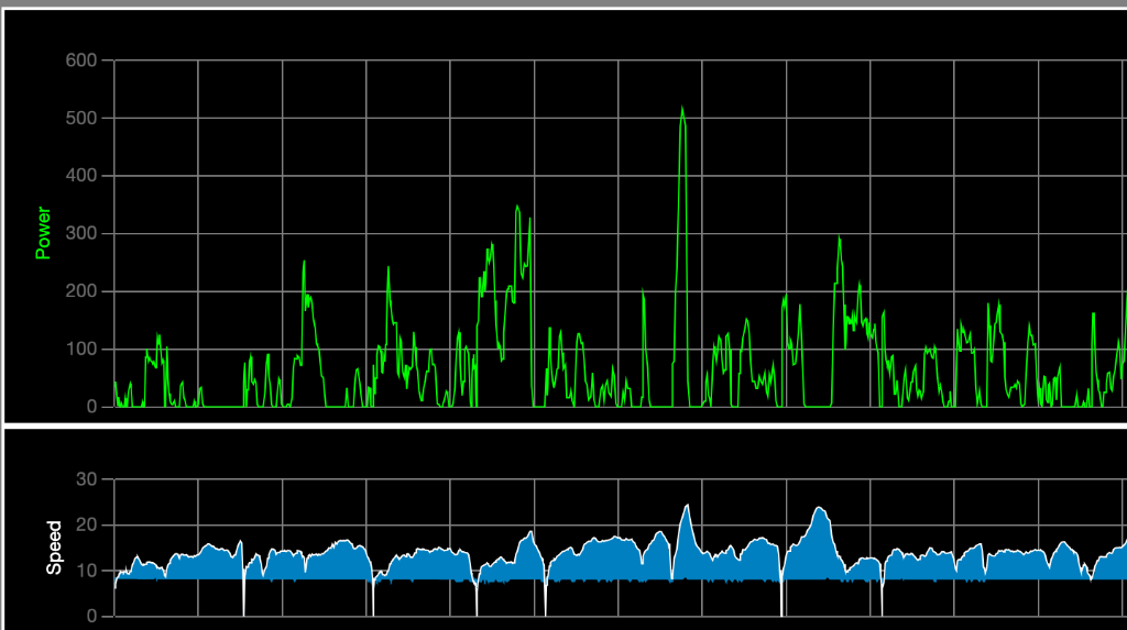

Re: Ignorance is Bliss
Your wind sensor is not functioning properly. It is under-reporting wind. This is the cause of your low watts.
- Screenshot 2024.png (110.28 KiB) Viewed 5630 times

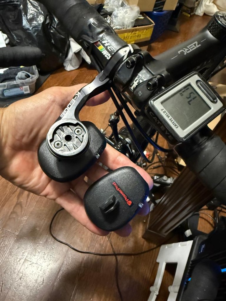

Either the recharge port would stop charging / or break, or the PP electronics would measure completely inaccurate numbers due to a non-repairable/malfunctioning power-measuring electronic issue in the unit, or the unit would simply die during a ride/not charge, or refuse to connect to the Velocomp Aero software anymore (like the most recent one - see the picture with it still attached to my bike - just before I now replace it with my "Hail Mary attempt" last, unused PP).
