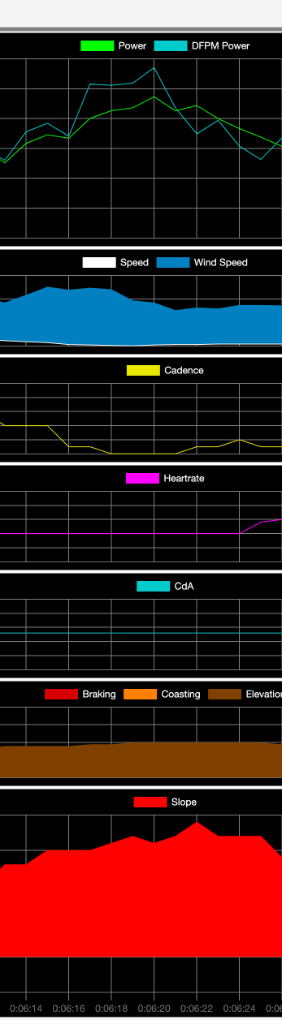

In looking at your ride file I see that you had, one time only, a 4 second interval where your DFPM power was a bit higher than your PP power. Two points:
1) Assessing cycling performance (or power meter performance) on the basis of a single 4-second burst of power is not terribly meaningful
2) At extremely short intervals, HOW the power measurement device measures stress becomes important. It's possible your DFPM over reported the maximum stress it experienced; it's possible your frame flexed a little bit, causing PP to underreport watts. It's possible, even likely, that there was a combination of these factors, and perhaps others.
Who knows?
After looking at ride files for 20 years, the only thing I know for sure is that no measurement device is perfect, and that the benefits of power measurement are most reasonably assessed over the course of an entire ride.
Who knows?
