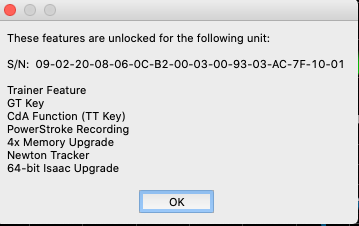

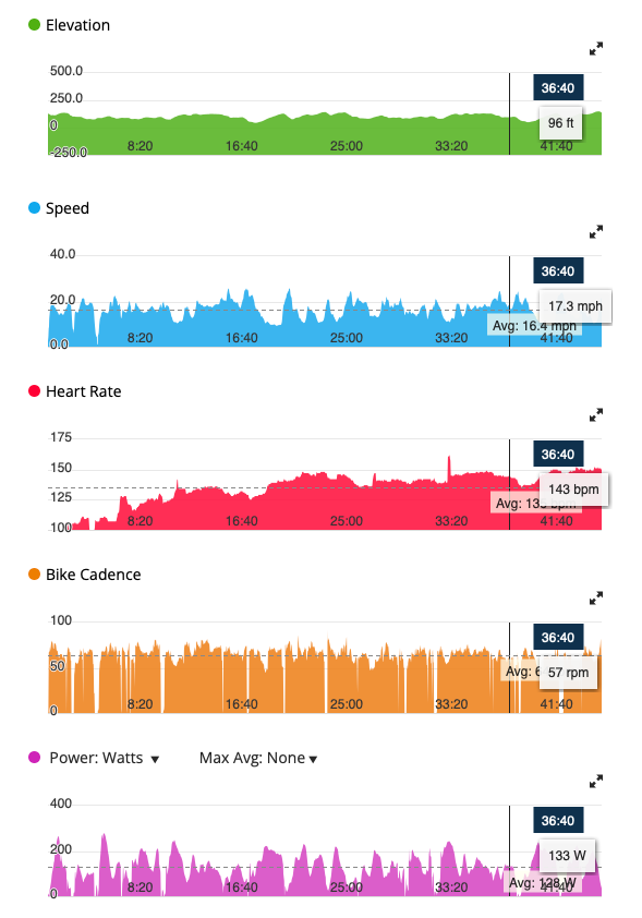

Pressed PP button this morning for 4 sec to force a re-scan for sensors and it did that I saw flashing green then green and red alternating which I knew meant I was forced to do an out and back cal ride. Did that, and for whatever reason even though PP has been doing 1 sec intervals and is set up to do power stroke, it recorded in non Hidef mode, but at least this time it did get the heart rate broadcast from my Fenix, but not the cadence even though the cadence sensor is working and seen by Garmin. I'm attaching the Garmin side screenshot and the PP Bike file as well as the screen showing the unlocked features. Please advise. Would really get back to full functionality -- but it's a good powermeter!!

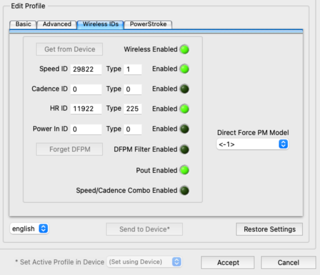

Posts: 7942
Re: PP suddenly totally wonky
Your cadence sensor was not picked-up during the scan (0 ID).
Sorry, but you'll need to do another sensor pairing and cal ride. Make sure your cadence sensor is awake prior to pairing. When you do the pairing you should see the light flash red 3 times, indicating that your cadence sensor was picked up.

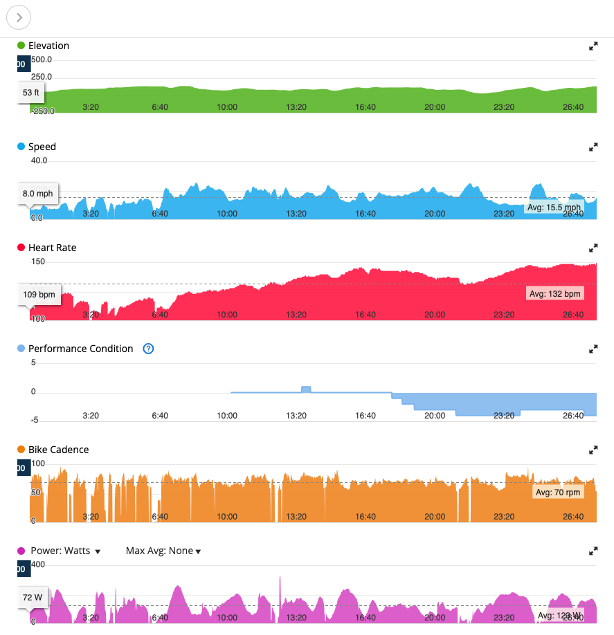

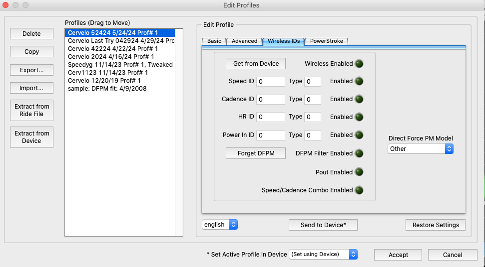

Thought it was fixed but still not recognizing cadence sensor. Appears to have speed and HR, but when I look in Isaac (after hitting "Get from Device") all the sensors are listed as zero and not wireless enabled. But the ride data shows speed and heart rate as well as elevation and slope. I will try pairing again but this is really a drag (NPI) I've now gone through this about 5 times. Cadence seen fine on Garmin head unit.
What to do?!?

lorduintah
Posts: 660
Location: Plymouth, MN
Post by lorduintah »
On occasion I have had trouble with my Garmin Cadence sensor. My Garmin Edge bike computer still sees the Cadence sensor.
I have taken the battery out and measured a voltage of around 2.9V or a little less than that.
A fresh Li battery usually measures around 3.3V.
Replacing those batteries does the trick. I would have expected there to still be enough left in those batteries, but the evidence says otherwise.
The other option is to flip the battery over and put the cadence sensor back to gather - resetting the ANT+ ID for the sensor.
