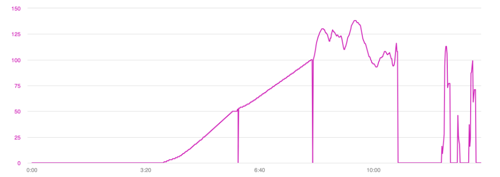

Re: Ride Not Recorded
This is the V3 ride
Power on the Garmin
