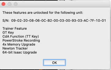

I am also getting no power stroke data despite having upgraded PP to Powerstroke.
Here's the data from Unlock status:
Screen Shot 2023-10-02 at 4.19.30 PM.png (20.01 KiB) Viewed 8770 times
And here's today's ride file (after doing the PStroke unlock last night
Velocomp_10_02_2023_1520_13_Miles.ibr
(146.04 KiB) Downloaded 393 times
What's my best course of action to get Stroke working.
I had it once but downgraded the unit because it was filling memory too quickly. Now would like to use it again.

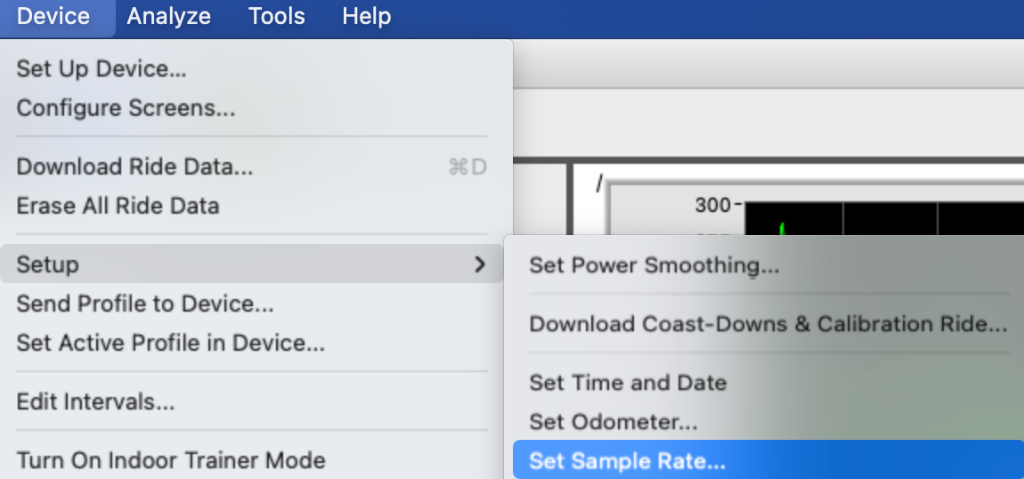

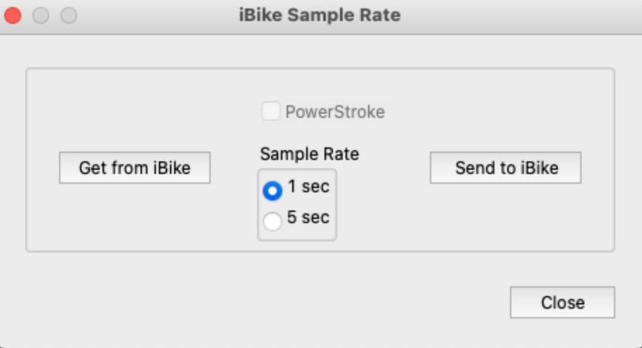

It sounds like PS may have been turned off.
Go to Device/Setup/Set Sample rate:
Screen Shot 2023-10-02 at 9.48.25 PM.png (243.47 KiB) Viewed 8757 times
Make sure PS is checked.
Screen Shot 2023-10-02 at 9.48.11 PM.png (47.33 KiB) Viewed 8757 times
If not check the PowerStroke box, then things should work afterwards.
