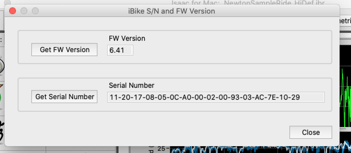

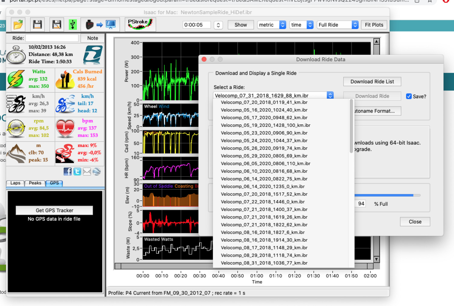

I've finally got connection with Isaac. Curiously I don't see the ride file for today. Last ride file is 3 years old. I've also seen that power smoothness was set to 5s. Set it up to 0 as you've suggested.
Serial number is this one:
Re: PowerPod lag
Your ride file from today is the one at the bottom of the ride file list; that is the one you should download. Its date is incorrect because the internal clock of your PP was not set.
Now that you've connected your PP to Isaac the internal clock will be reset to the correct date/time.
Your PP data storage is nearly full so, after downloading your latest ride, use the command "Device/Erase all Ride Data" to clear your PP memory.

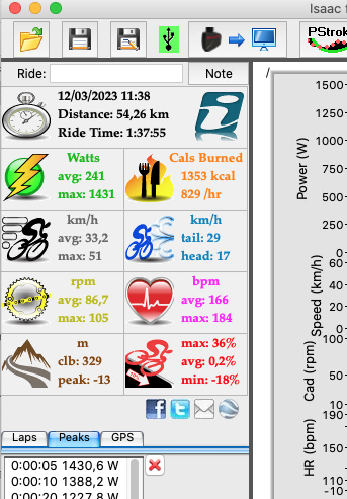

Can you see what's going on with this last ride? Every other Z2 ride seemed fine but today I went for a more fast paced one and I don't believe that I am in this kind of shape right now.
For sure PP spiked at the very beginning of the ride but after a couple minutes if seemed to settle down. Anyway my power numbers to this ride seems exaggerated to m eye, even if PP doesn't agree with my Wahoo Roam V2 for average speed. PP returned 33,2 and my Wahoo 34 flat (that's a 0,8 km/h difference!):
Velocomp_03_12_2023_1138_54_km.ibr
(341.75 KiB) Downloaded 579 times
Re: PowerPod lag
naavt wrote: Sun Mar 12, 2023 1:02 pm Hi John,
1) Don't worry about average speed differences. How Wahoo measures average speed can differ from Isaac method, especially if there is any time delay between the two devices.
2) The first two minutes of your ride is where PP recalibrates itself, and wattage data here is meaningless. You should edit-out this part of your ride file
3) There are indications that your mount angle is changing during steep accelerations; this could cause high watts. Make sure your PP is firmly attached to your mount so that it cannot rotate, and make sure your handlebars and fork tube are securely attached to the bike, so that there is no play in them.
