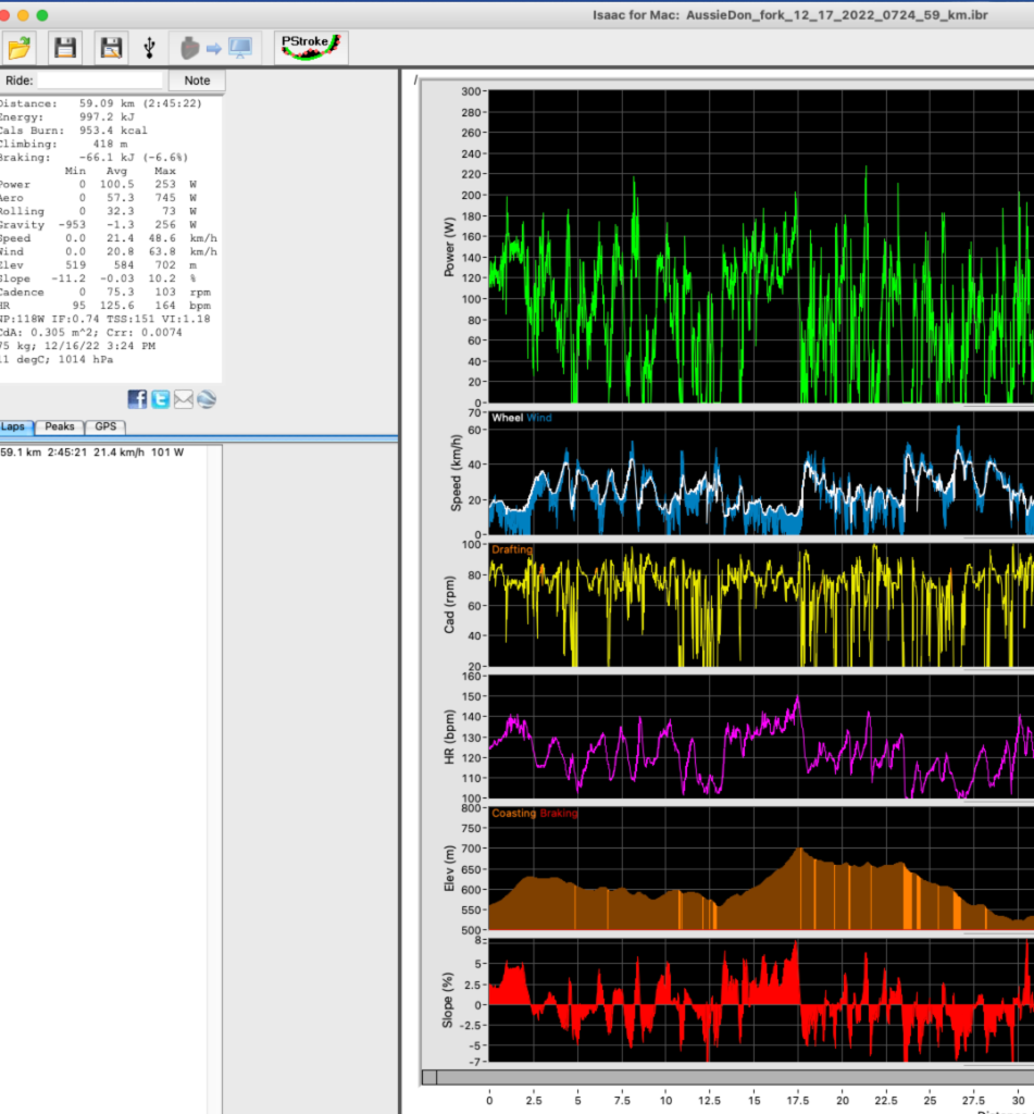

Here's a recent ride file with the PP V1 mounted on the fork.

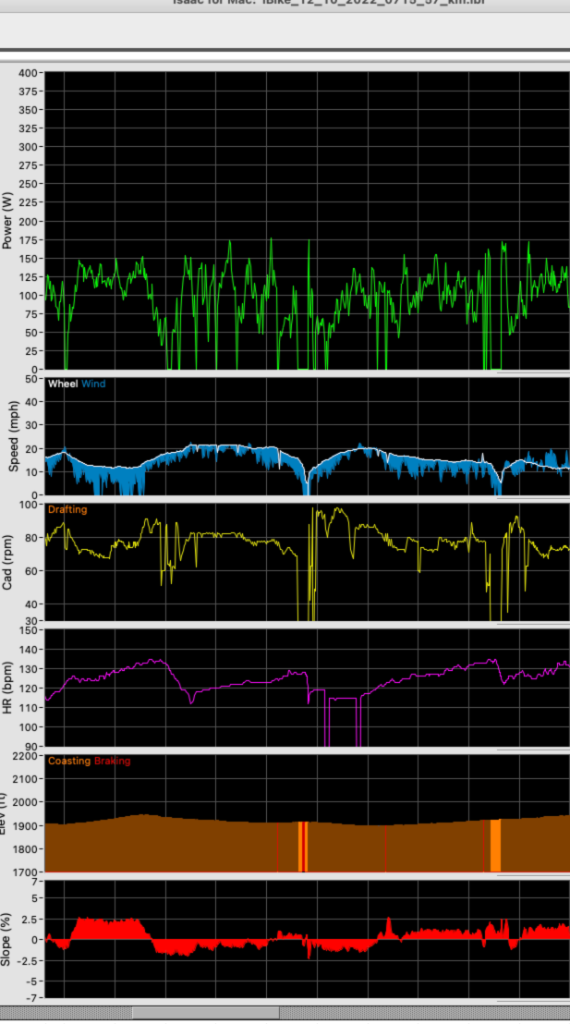

AussieDon wrote: Sat Dec 24, 2022 11:03 pm Here's a recent ride file with the PP V1 mounted on the fork.
I looked at your ride file. The only bothersome thing I see are periodic speed sensor dropouts, which will cause power dropouts. What kind of speed sensor are you using, and where is it mounted?
I don't see any evidence that your shock stem is causing problems. MTB with front suspensions are quite different and potentially can cause problems.
Screen Shot 2022-12-26 at 5.16.44 PM.png (207.62 KiB) Viewed 7540 times

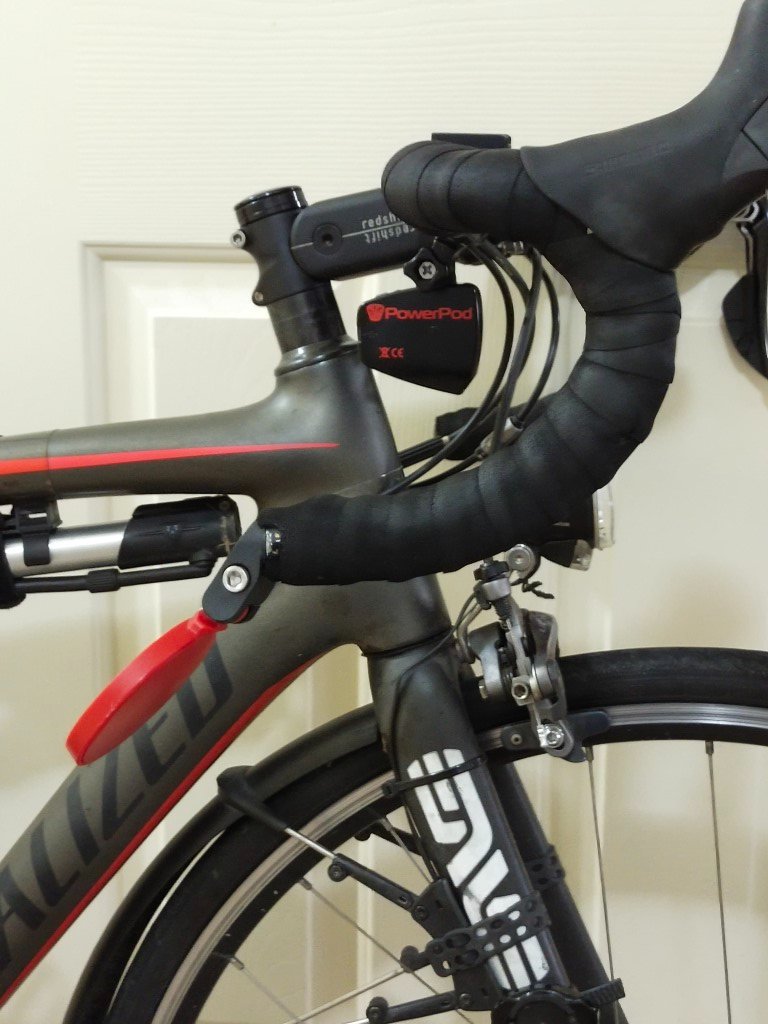

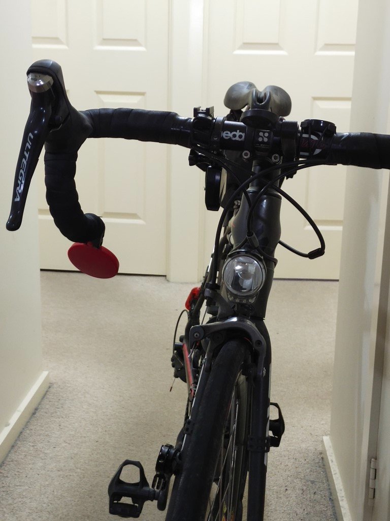

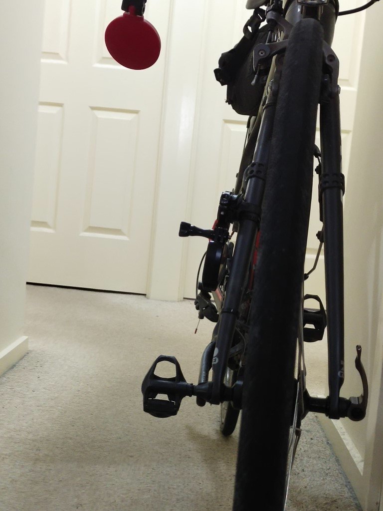

Here are the photos. I took shots from the front and side for both configurations to illustrate that there are no obstructions in the bar mounted position and to show the gap between the PP and fork in the fork mounted position. It's not a big gap so I think the PP V5 would not work in a fork mount configuration with my existing attachment.
I hope this helps.
Fork mount front
Fork mount front
PP fork mount front.jpg (101.18 KiB) Viewed 6875 times
Bar mount side
Bar mount side
PP bar mount side.jpg (112.21 KiB) Viewed 6875 times
Bar mount front
Bar mount front
PP bar mount front.jpg (107.39 KiB) Viewed 6875 times

Re: PowerPod and ShockStop Stem by Redshift
Lots of comments:
1) I looked at the slope correction data for your rides. This data shows the effect of mount rigidity. There is some difference between fork and bar mount rigidity. The fork is more rigid, but at only one point in the bar ride (around 50km) is there a significant shift in calibration correction. This is on a downhill and might be a result of stem flex. This affected watts for only about 40 seconds; after that the unit self-corrected. Overall, I don't think stem flex is a material issue for you and you can mount your PP on your bar.

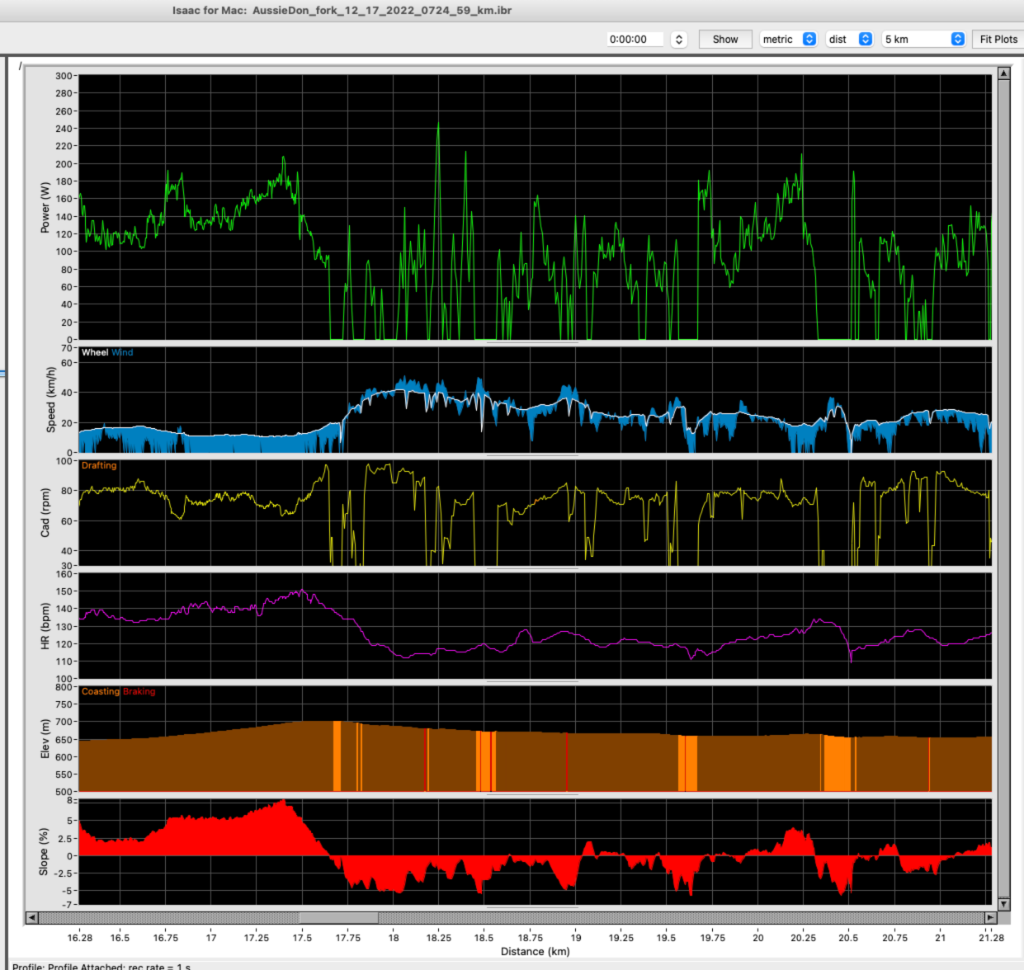

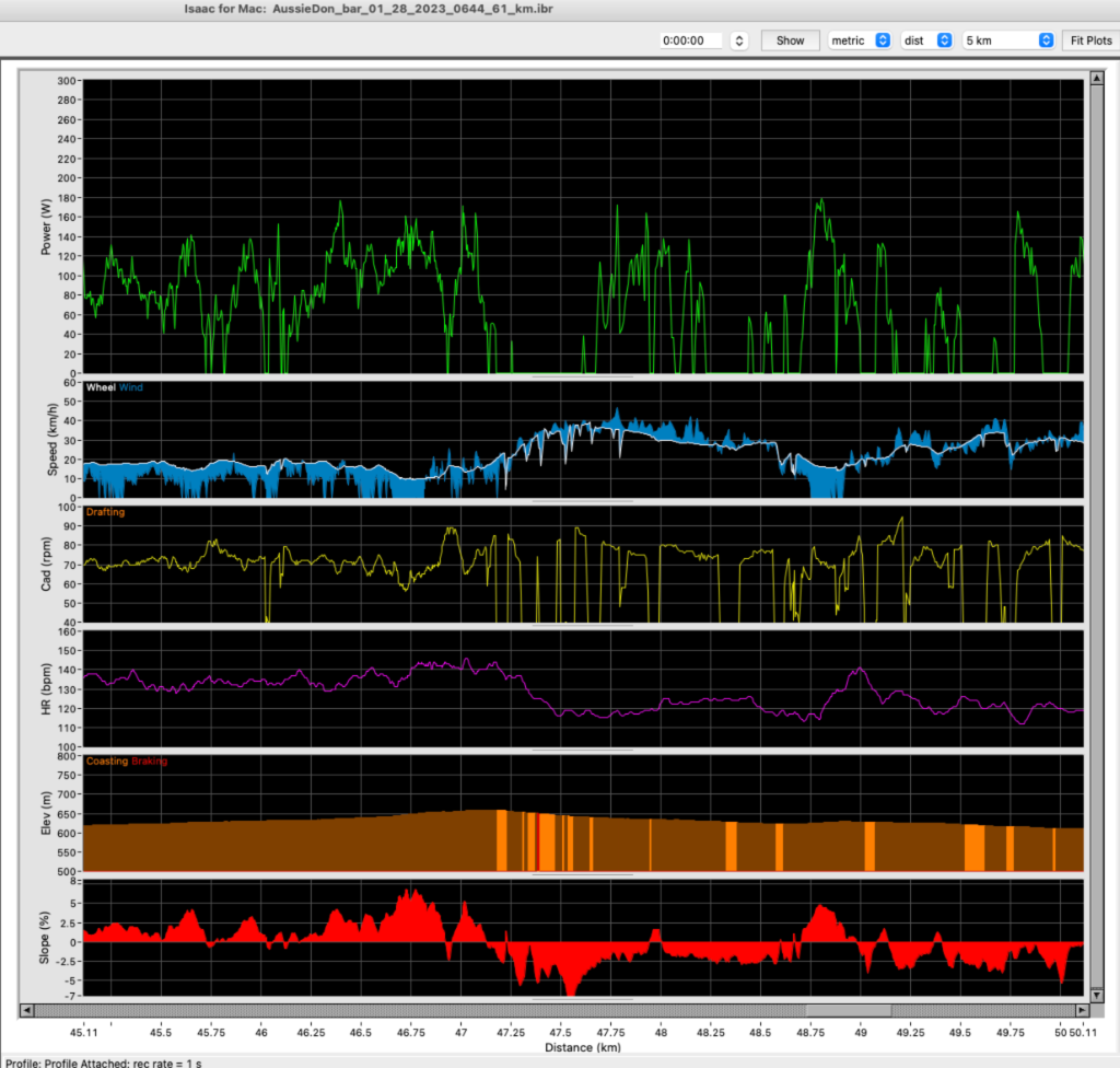

2) What IS worrisome is that you have spikes in your speed sensor data, both in the bar and fork files
Fork
Bar
Speed spikes will cause power dropouts and also might affect calibration. What kind of speed sensor are you using and where is it located? I would change its battery...

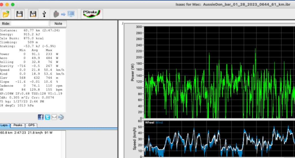

3) The biggest factor affecting your watts is wind. On the 12/17 ride (fork) you had a net tail wind for the ride of -0.6 km
Fork stats.png (409.9 KiB) Viewed 6860 times
On your 1/28 ride (bar) you had a net tail wind of -2.9 km/h
Bar stats.png (278.18 KiB) Viewed 6860 times
Riding In a tail wind takes less power, and the stronger the tail wind, the less power is required. . You rode faster because the tail wind was helping you. You had lower watts because the tail wind was pushing you forward more than required to achieve the slightly higher bike speed.
I don't think the lower watts are attributable to the shock stem, and I don't think the shock stem is a material factor in your ride stats.
