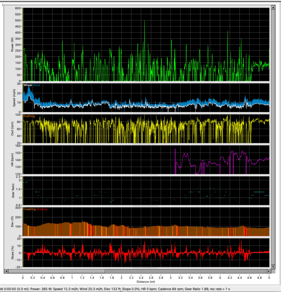

Here's the ibr file that includes my attempt to calibrate at the beginning. This is a fat bike ride in snow. The calibration portion was done on the road before heading into the trails. FYI -- any heart rate data contained in the file isn't mine.
Thanks for help figuring this out.
- Velocomp_12_31_2021_1402_13_Miles.ibr
- (527.34 KiB) Downloaded 227 times
Re: PP calibration ride issues
1) We no longer record calibration files separatelyjello242 wrote: ↑Sat Jan 01, 2022 6:32 pm Here's the ibr file that includes my attempt to calibrate at the beginning. This is a fat bike ride in snow. The calibration portion was done on the road before heading into the trails. FYI -- any heart rate data contained in the file isn't mine.
2) Your PP is calibrated; I can tell this because the wind factor is not "preset"
3) It may be the case that your cadence sensor is intermittent; you can see this because there are a LOT of cadence dropouts at the beginning of your ride
4). You have a HR wireless ID in your profile, so it would seem that you did your sensor pairing when you were near someone else who was wearing a HR strap. If this is not yours then I would do a new sensor pairing (and cal ride).
- Screen Shot 2022-01-02 at 12.10.23 PM.png (410.64 KiB) Viewed 4669 times
You're traveling quite slowly during your cal ride. That's OK, except that, at the 50W mark, PP thinks your slow speed means you've turned around. It keeps counting up as a consequence.jello242 wrote: ↑Sun Jan 02, 2022 3:20 pm Thanks John. Yes, I forgot my HRM and was with someone else who had one on.
I’ll see if I can figure out the cadence drop-outs. Other than that are you saying everything looks good for the fat bike? Is the auto-calibration at the start of every ride taking care of the differing resistance of the snow?
Also, is there a new procedure to perform for out and back calibration since it’s not stopping at 50 or do I just need to keep a close eye on the tick up to 50 so I can turn around at that point?
Thanks again,
Joshua
To get around this problem at the 50W mark turn around anyhow. Your cal ride will complete itself as planned.
