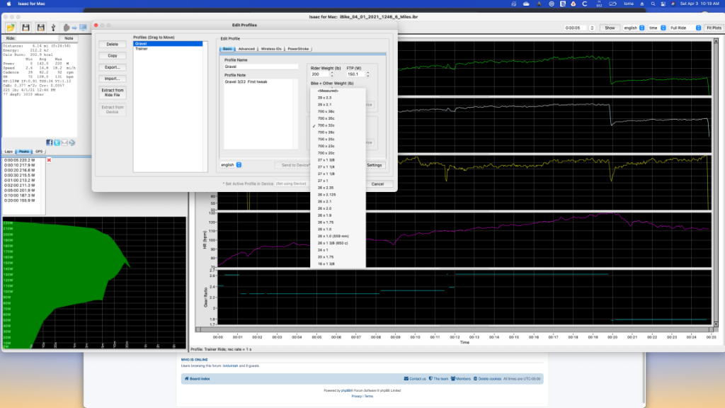

Re: New User with a couple of questions
The EDIT Profile Screen.
Bringing the Tire Sidewall Marking list open as a DROP DOWN.
Notice the top entry <Measured> --- Select that choice by highlighting it.
You can then change the value of the CIRCUMFERENCE - to your desired tire size. Then ACCEPT the changes and finally SEND TO DEVICE.

Thanks lorduintah, I found out about the measured wheel circumference after watching a couple video's. Appreciate the information. Did another calibration ride yesterday. Got everything dialed in. Went out for 50 mile ride today and everything is working great. Very happy with my powerpod.
