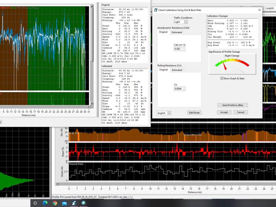

Hi, I have did a out and back calibration ride, during ride I experience a constant breeze. Looking at the check calibration data, the "significance of change" status bar was closed to green (between green and yellow to be specific) and therefore I am uncertain whether did the calibration data is acceptable. I am concerning about the wind factor because I knew that it is best to do a cal ride without any wind.
However, if I am going to switch the Cda to "Estimated", the pointer will goes towards the green. Slightly better instead.
I am uncertain whether to redo the calibration or to accept the data.
Before I proceed, I would need some advise whether is this cal ride data acceptable?
I have attached the following files for your review.
- Out-Back Cal Ride.csv
- (652.63 KiB) Downloaded 179 times
- Cal Screenshot.jpg (128.09 KiB) Viewed 4485 times

Re: Out-and-back calibration ride - Acceptable?
Sorry, I wasn't clear enough. Please post a ride file AFTER your cal ride.
The calibration looks fine, although at mile 22 it looks like your unit was bumped out of position. PP automatically corrected this problem after a few minutes.
If you stopped during the ride, it is likely PP broke-up the ride file at that point.
I am attaching a corrected ride file, which deletes the segment around mile 22, and joins the three ride files together.
