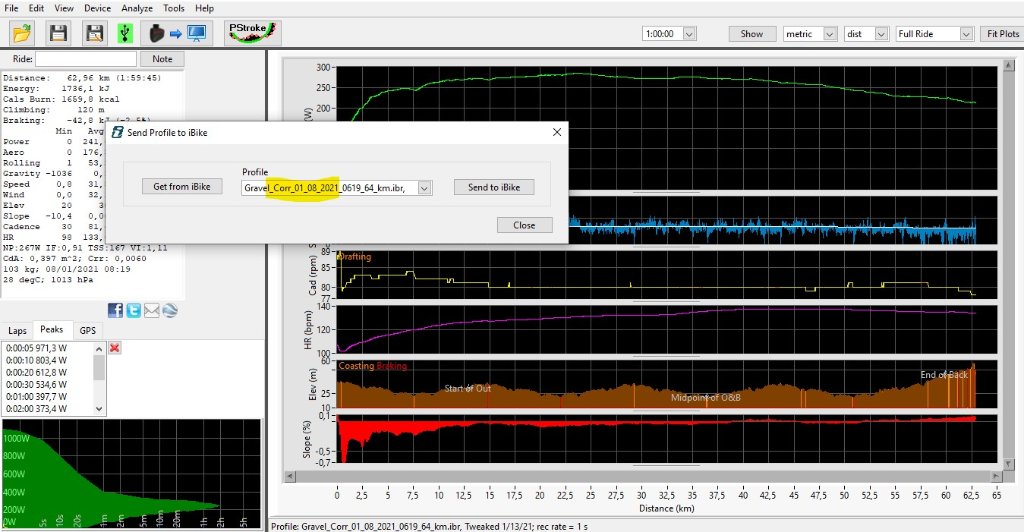

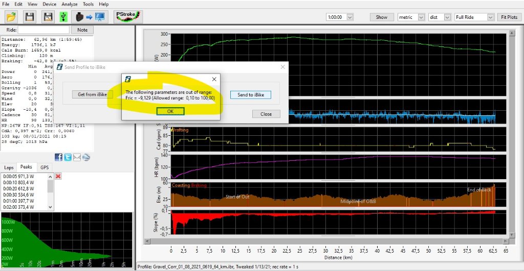

Hello John, thanks again for your attention.
I must be doing something wrong when sending the corrected profile to my PP. Isaac is giving me these screens below.
If I happen to have a tutorial where I can learn how to update the profile, I am grateful.

Re: I think I am generating a lot of power. Can you help me check please?
This screen means that your profile for this bike is too far away from its original setting.
I've artificially altered your profile so that you should be able to load it. After loading it do a short ride; your PP will be way out of calibration for the first few minutes, but it should correct itself after a bit. Download and post the ride.
If this doesn't work, then please do a new calibration ride with your gravel bike, then post that ride afterwards to me for any required correction.
